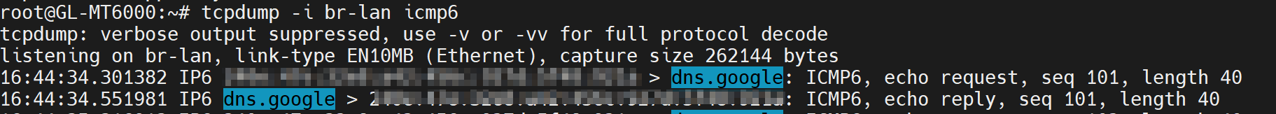

Thank you, this is the output of tcpdump on the Flint 2:
tcpdump -i br-lan icmp6
tcpdump: verbose output suppressed, use -v or -vv for full protocol decode
listening on br-lan, link-type EN10MB (Ethernet), capture size 262144 bytes
10:58:50.958390 IP6 2a02:908:532:bca0:1e69:7aff:feaf:7455 > dns.google: ICMP6, echo request, seq 2, length 64
10:58:51.091701 IP6 GL-MT6000.lan > 2a02:908:532:bca0:dc3b:ad14:b993:b752: ICMP6, echo request, seq 0, length 8
10:58:51.982514 IP6 2a02:908:532:bca0:1e69:7aff:feaf:7455 > dns.google: ICMP6, echo request, seq 3, length 64
10:58:52.160428 IP6 fe80::9683:c4ff:feaa:be4e > ip6-allnodes: ICMP6, router advertisement, length 104
10:58:52.916708 IP6 fe80::642:1aff:fe33:a5c0 > fe80::9683:c4ff:feaa:be4e: ICMP6, neighbor solicitation, who has fe80::9683:c4ff:feaa:be4e, length 32
10:58:52.916842 IP6 fe80::9683:c4ff:feaa:be4e > fe80::642:1aff:fe33:a5c0: ICMP6, neighbor advertisement, tgt is fe80::9683:c4ff:feaa:be4e, length 24

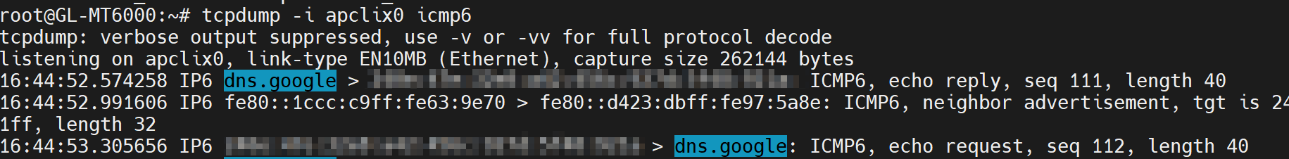

and
tcpdump -i eth1 icmp6
listening on eth1, link-type EN10MB (Ethernet), capture size 262144 bytes
10:59:17.583092 IP6 2a02:908:532:bca0:1e69:7aff:feaf:7455 > dns.google: ICMP6, echo request, seq 28, length 64
10:59:18.607086 IP6 2a02:908:532:bca0:1e69:7aff:feaf:7455 > dns.google: ICMP6, echo request, seq 29, length 64
10:59:19.185493 IP6 fe80::10:18ff:fe3f:3194 > ip6-allnodes: ICMP6, router advertisement, length 104
10:59:19.631094 IP6 2a02:908:532:bca0:1e69:7aff:feaf:7455 > dns.google: ICMP6, echo request, seq 30, length 64
10:59:20.655064 IP6 2a02:908:532:bca0:1e69:7aff:feaf:7455 > dns.google: ICMP6, echo request, seq 31, length 64
10:59:20.749724 IP6 fe80::9683:c4ff:feaa:be4c > fe80::10:18ff:fe3f:3194: ICMP6, neighbor solicitation, who has fe80::10:18ff:fe3f:3194, length 32
10:59:20.751727 IP6 fe80::10:18ff:fe3f:3194 > fe80::9683:c4ff:feaa:be4c: ICMP6, neighbor advertisement, tgt is fe80::10:18ff:fe3f:3194, length 24
No reply packets, as far as I can see.
When I ping dns.google from a different client (WiFi), tcpdump shows this:
11:04:08.714900 IP6 2a02:908:532:bca0:2c8a:ae13:4136:881a > dns.google: ICMP6, echo request, seq 5, length 16
11:04:08.726944 IP6 dns.google > 2a02:908:532:bca0:2c8a:ae13:4136:881a: ICMP6, echo reply, seq 5, length 16
11:04:09.044433 IP6 GL-MT6000.lan > 2a02:908:532:bca0:2c8a:ae13:4136:881a: ICMP6, echo request, seq 0, length 8
11:04:09.096063 IP6 2a02:908:532:bca0:2c8a:ae13:4136:881a > GL-MT6000.lan: ICMP6, echo reply, seq 0, length 8
11:04:09.644195 IP6 2a02:908:532:bca0:2c8a:ae13:4136:881a > 2a02:908:532:bca0:10:18ff:fe3f:3194: ICMP6, neighbor solicitation, who has 2a02:908:532:bca0:10:18ff:fe3f:3194, length 32

inet6 <ip-address>/64 scope global dynamic mngtmpaddr noprefixroute
Could it be that this affects connections to external machines using IPv6? I compared this with another Ubuntu server, which has the static address with noprefixroute, but also a temporary address without that tag.
