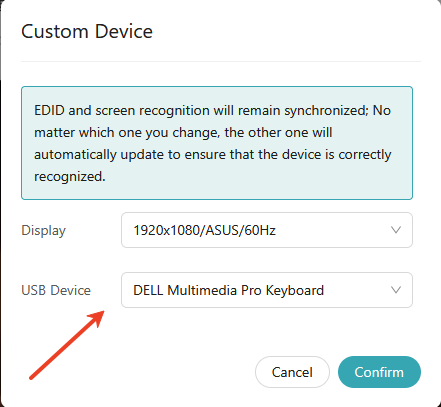

can you upgrade to 1.4.0 beta1 . try the Device Identity function and see any help?
According to the logs, the USB-C control cable is not connected. There are several possible reasons for this, such as using the wrong cable or the controlled computer rejecting the current device ID(which might be fixed by disguised to another device).
