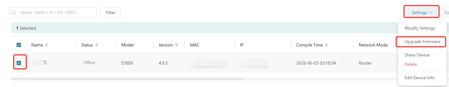

Alternatively, you could also try upgrading the firmware remotely through GoodCloud.
GoodCloud guide:
