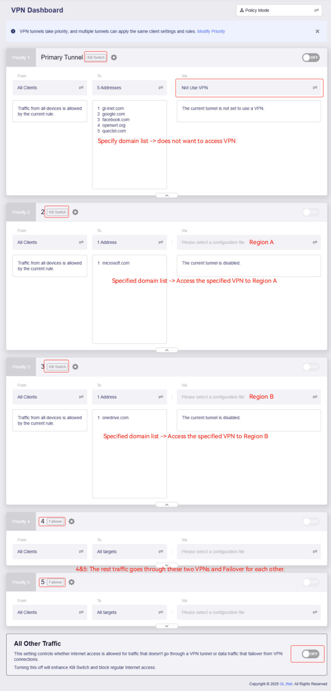

In firmware v4.8, multiple VPN tunnels are supported, and the specified clients are allocated to specific tunnel according to the MAC.
I think up to 5 tunnels can be supported:
(This is not your needs, only refer to the ability to build 5 tunnels, allocate clients according to your needs)
That is not VPN cascading, but multi-VPN tunnel feature.
