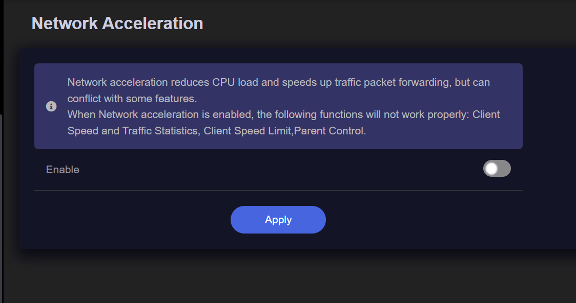

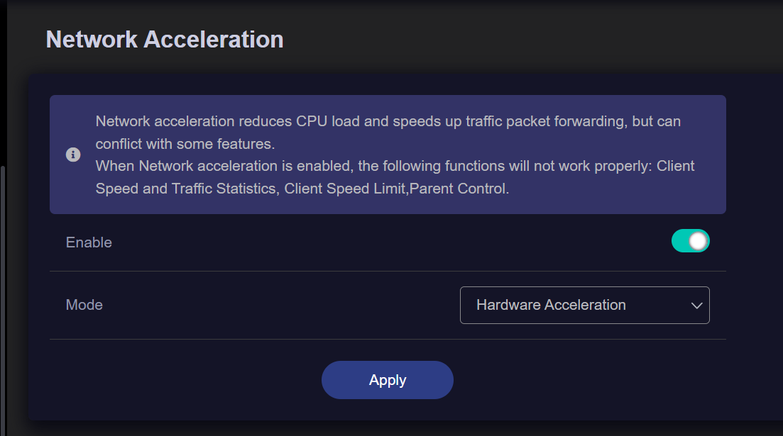

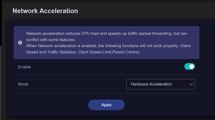

Thanks for the reply. I found the issue! On the 4.7.2 Beta, it seems that hardware accelleration under Networks > Network Acceleration is disabled by default. I enabled this and all is well. I am getting around 500Mbps now :slightly_smiling_face:
