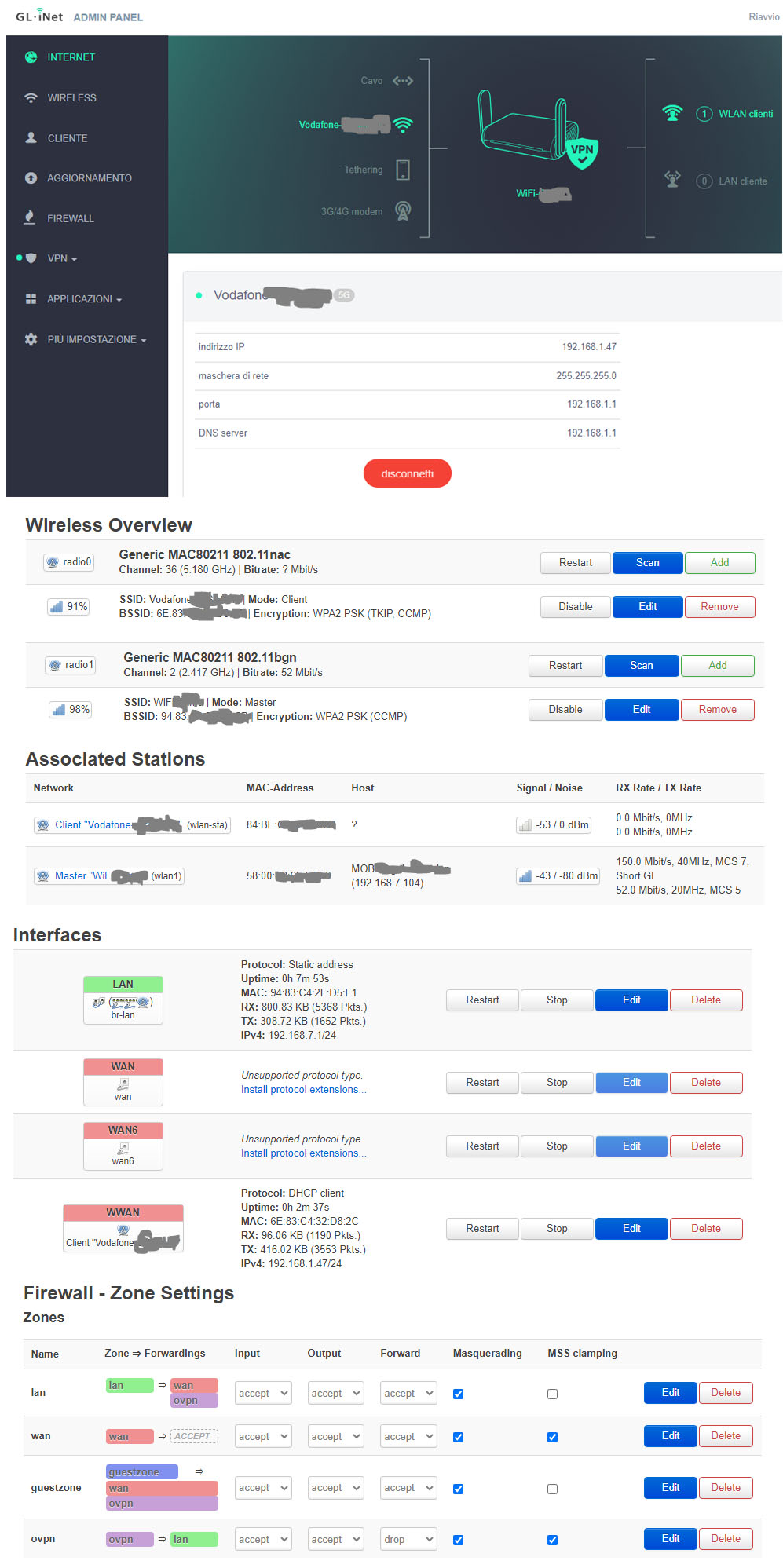

I configured a router (I have several Opals and a Mango) to connect via WiFi to an internet network in DHCP, connect to an OpenVPN as a Client, and configured a local subnet with a different class (192.168.7.1/24) on the local LAN side ( rj45 and WiFi master); this is to be able to reach the devices of the gl.inet local network (those with class 192.168.7.1/24) with portforwards from the VPN and everything works perfectly. The problem, however, is that the devices on the local network (192.168.7.1/24) do not have access to the internet. How can I solve it? I believe that the problem is the different network class, between the local network and the WiFi internet network.

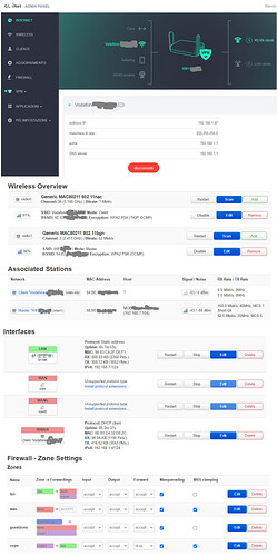

I attach some configuration screens

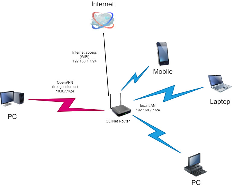

Thanks for the suggestion, I made a diagram of the system, in practice the class 192.168.7.1/24 does not access the internet.
What’s the openvpn server?
