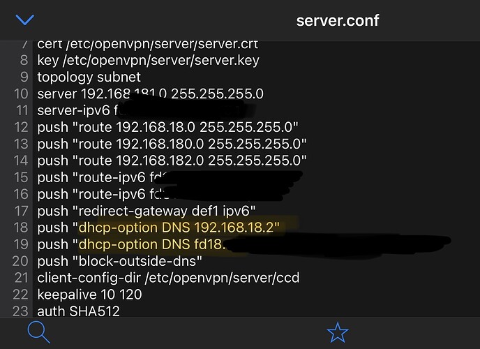

My OpenVPN server is configured to push exactly two DNS servers to the client:
  • one local IPv4 DNS (192.x.x.x)
  • one local IPv6 DNS (fd18::xxxx)

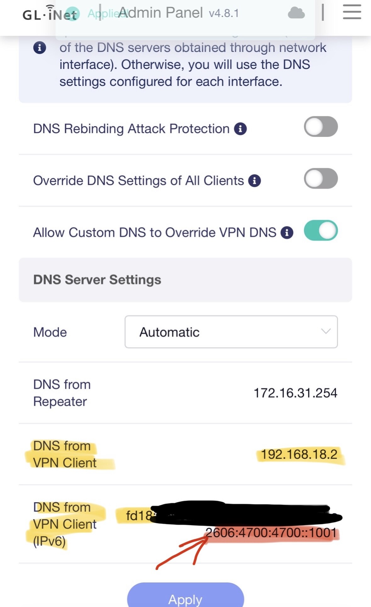

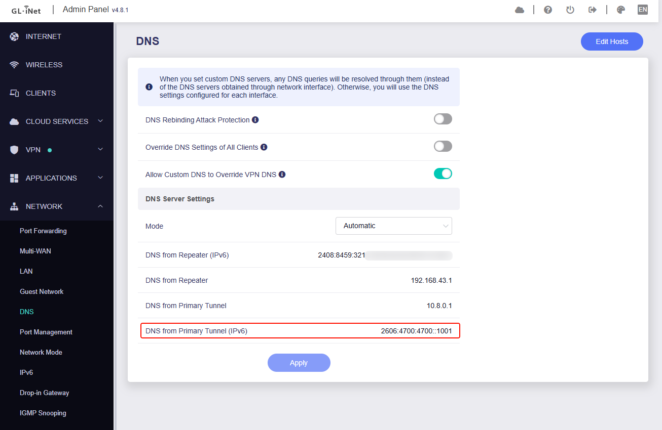

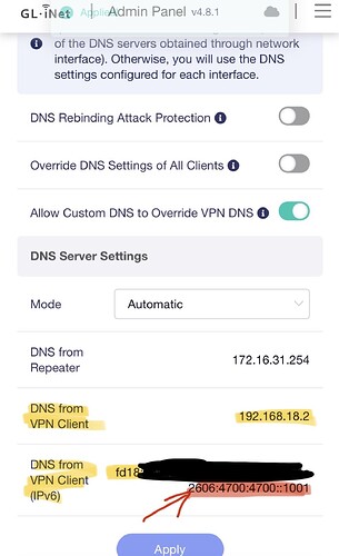

However, on the Beryl AX the OpenVPN client receives the same two DNS servers but additionally adds a public Cloudflare IPv6 DNS (2606:4700:4700::1001), which I have never configured anywhere. Because of this, the router sometimes uses Cloudflare instead of the local DNS, which breaks my intended setup.

  1. Configure an OpenVPN server to push only two DNS servers (one IPv4, one IPv6).

  4. Check the assigned DNS servers – the two correct ones are present, but an additional Cloudflare IPv6 (2606:4700:4700::1001) is added automatically.

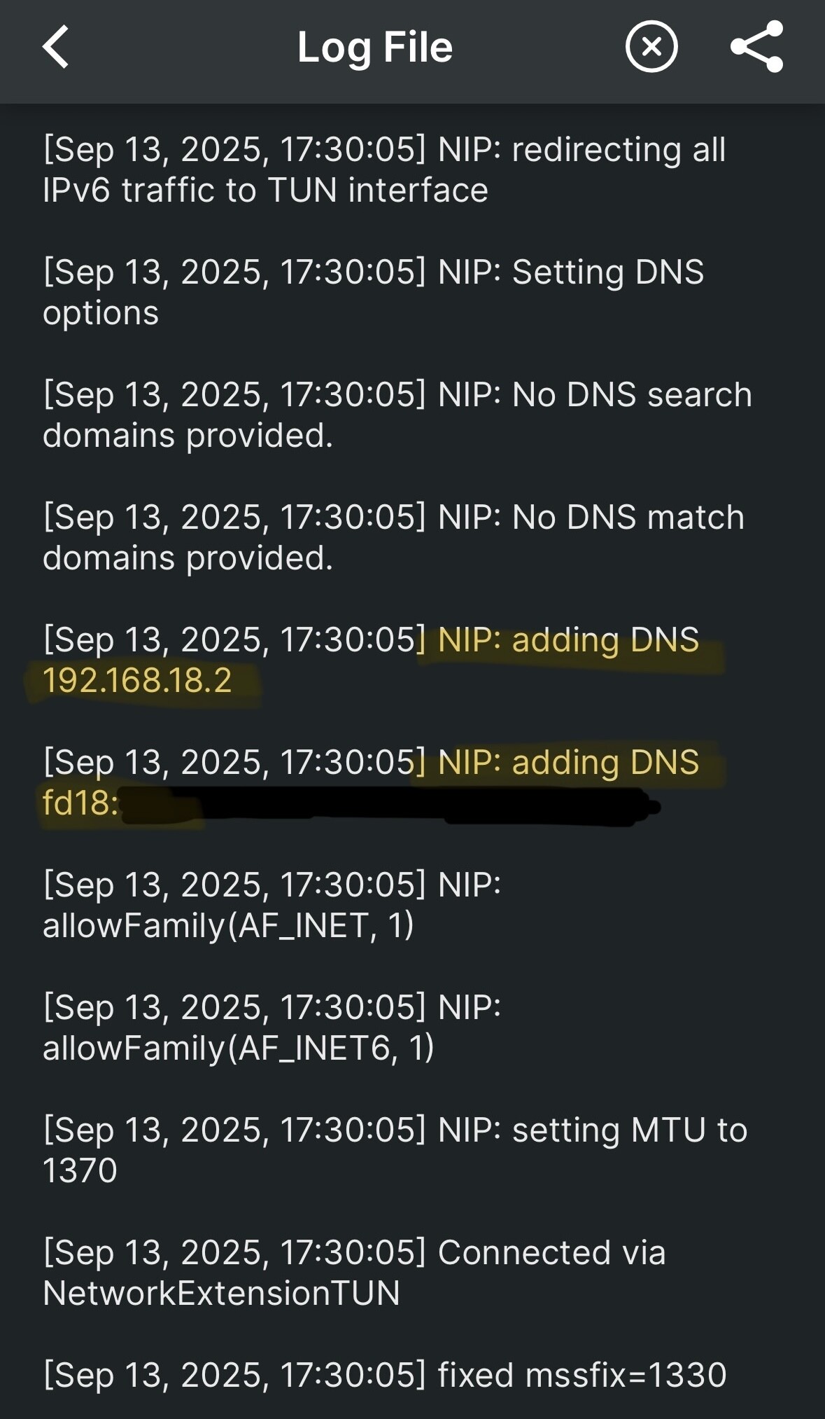

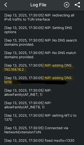

  5. Compare with iOS or Windows OpenVPN clients, which correctly only use the two pushed DNS servers.

  1. Server config – showing only the two DNS addresses being pushed.
  2. Beryl AX status – showing the two correct DNS plus the unwanted Cloudflare IPv6 address.
  3. iOS client log – showing the correct behavior with only the two pushed DNS servers.

I have reproduced this issue locally and we will submit it to R&D for confirmation and repair.
Sorry for the inconvenience.
Thanks again for your feedback.
