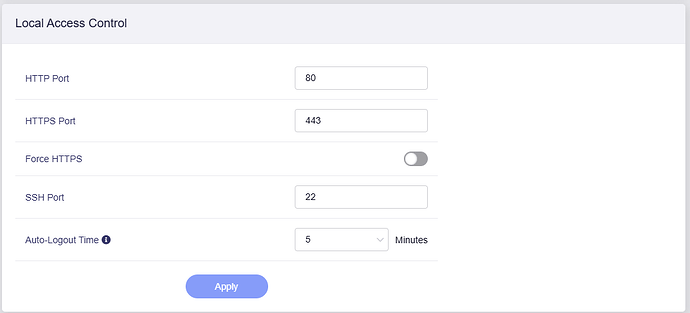

The 443 port uses HTTPS accessible in in GL GUI. But it only for LAN access under the GL router, so it can not conflict the WAN, please check your network devices.
OpenVPN is not required the port 443.
The default port of the OpenVPN is 1194, or others port number also work ok.
Thanks. I understand but I am trying to use ports which are often not blocked when travelling. That's why I was thinking of using 443 for OpenVPN but my concern is if I do that what https port can I put for LAN? Thanks
You can use other ports for https e.g. 444
