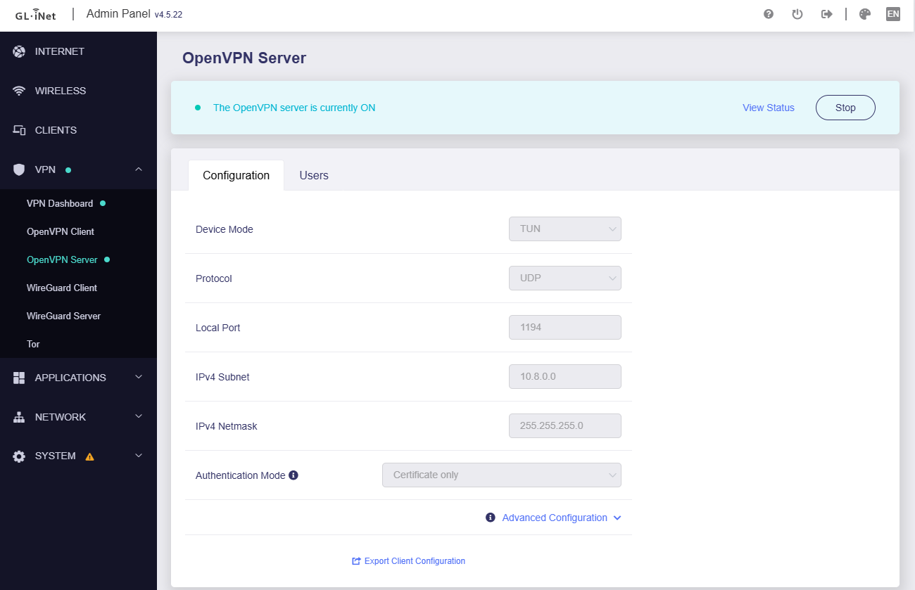

Is the OpenVPN server enabled in the GL GUI?

firmware is 4.5.22, latest stable. OpenVPN server is enabled, but I rebooted the Marble and VPN server was down.

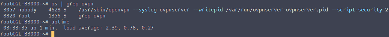

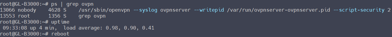

After repeatedly restarting and test, the OpenVPN server was not shut down always, and the process is property.
What settings of OpenVPN are?
