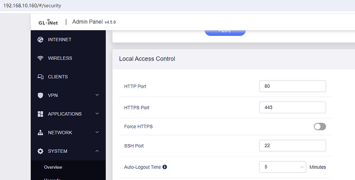

In firmware 4.5, a security page was implemented, enabling users to customize the nginx port other than the standard 80 or 443. Flint 2 leads as the initial model to adopt this version.

However, since I already had the protocol ā€˜hack’ setting configured, the upgrade replaced the gl.conf file with the original default SSL 443 port settings so the web GUI was not accessible since the OpenVPN connection started first using the TCP/443 port. Anyway, I manually changed the gl.conf file again to 4433 and rebooted so I could get into the web GUI. I then stopped the OpenVPN server and changed the OpenVPN server back to TCP/1194, and then changed the gl.inet file back to the default SSL 443 and rebooted. After the reboot, I used the GUI settings to change the Security page HTTPS port to 4433, and then changed the OpenVPN server to TCP/443 natively now. SWEET!
