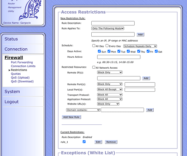

For consumer router “parental” control, blocking, quotaing, monitoring, as far as I’m aware Gargoyle Router is the best option out there.
Based on DDWRT it allows you granular control for IP address, IP ranges, download quotas, time restriction and you can do a whole lot of different filtering/blocking.
Takes a little bit of time to work out the logic and to setup but a great tool if you’ve need to restrict or monitor those kids or flatmates :slight_smile:
Sadly it only runs on the AR150, MT300N, MT300N-V2 and AR750
thx for intro,
i saw in ur photo, that one can block by website URL(s).
this is lacking in openwrt’s “firewall”.
when google, for openwrt everyone say “'it’s possible by editing a BUNCH of files”.
i say F_ _ _ Off.
ps: still, TP1ink C2’s rom is let you choose A. device mac/ip, B website ip/URL, C time schelue, among other things like protocol etc. And add new rules by clicking a combination of the above.
That’s the best GUI I think.
