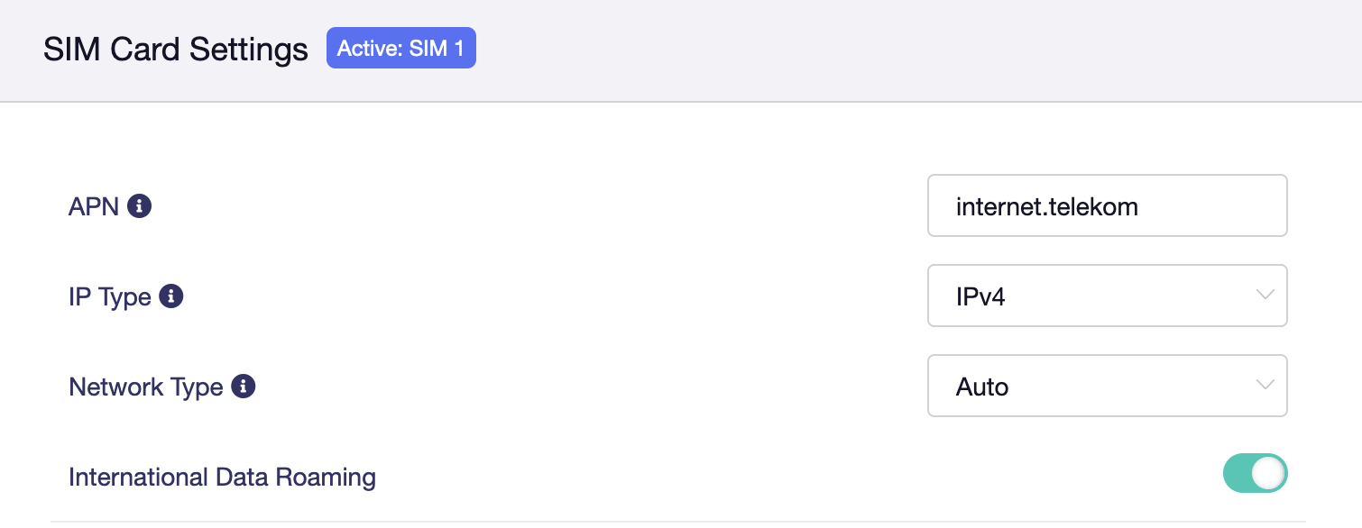

Hello, we have made some adjustment. When using the feature Operator Lock, please select a network with the "AUTO" Network type. This will allow the router to connect to the 5G NSA. Please see if this works
tnx for coming back to my case.

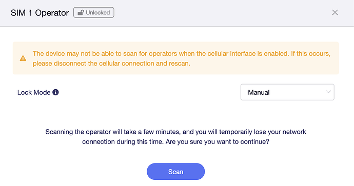

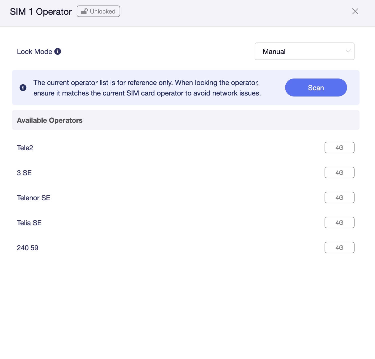

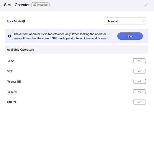

unfortunately does not work and my screen looks slightly different:
I can only lock the operator in combination with the network type (in my case 4G).
On the same spot I can lock nicely just the operator with my iPhone or android (also on 5G NSA).
