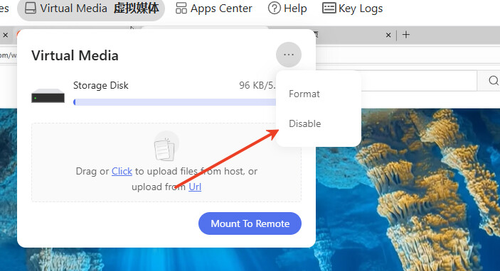

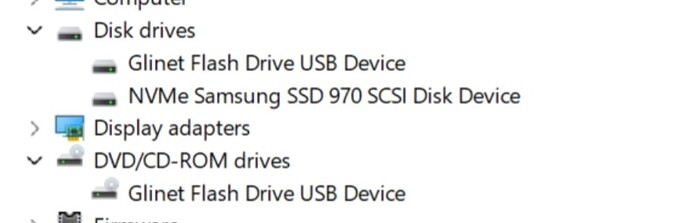

I suggest you simply disable virtual media to prevent the emulation of USB drives and CDROMs on the controlled computer. I suspect most IT software wouldn't flag a brand they don't recognize.

As you mentioned, disabling virtual media is a good step. I also updated the /etc/kvmd/override.yaml file to restrict USB gadget mode to HID-only (keyboard/mouse).

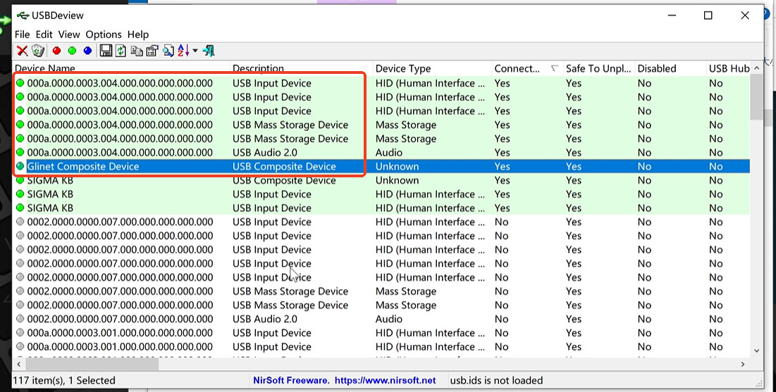

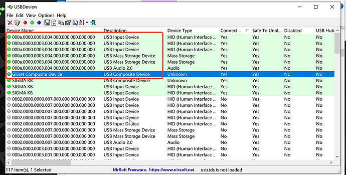

Can I scan with any software or is there a way to check what GLKVM shows itself as both HDMI and usb
The devices circled in red are those that will be emulated by GLKVM. In reality, only the composite device displays its name.
Before version 1.4.0, they were displayed as GLKVM Composite Device, and after version 1.4.0, they are displayed as Glinet Composite Device.

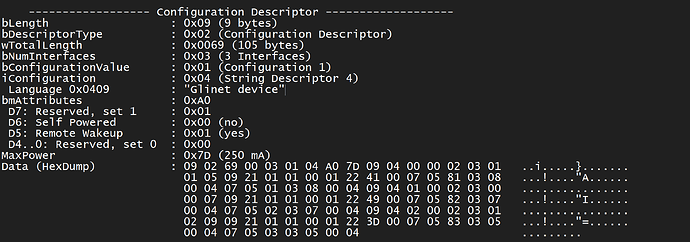

@minmie The “Customize” option mostly works, but if you load the resulting device in USBTreeView you can see that regardless of your custom setttings it still identifies as a '“Glinet Device” in the configuration descriptor. It also defaults to a serial of CAFEBABE, which is a PIKVM v2 default.
This could be really bad news for someone who didn’t want it to be recognized and thought that customizing it would help.
Yeah. Regarding the serial number, we might make some optimizations in the future, but I should mention that it can be modified when customizing the identity. As for the GL.iNet device, I’ll look into how to handle it.

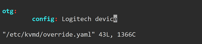

This worked for me to fix the “Glinet Device.” I’m not sure if that breaks anything downstream though, it’s just what I came up with while tinkering and it seems to work. Do you know if changing override.yaml will persist, or will the next update erase it?
