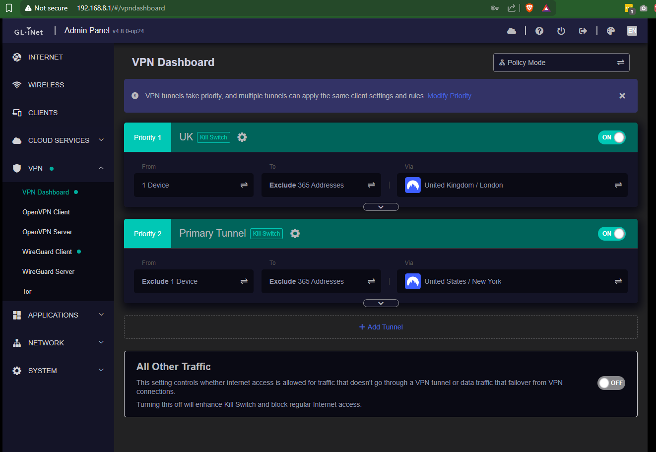

I am observing a strange behavior with my configuration, and I'm wondering whether it's a firmware bug or just my stupidity.
I am running v4.8.0-op24 (openwrt-mt6000-4.8.0-op24-0729-1753791445).
I have configured two Wireguard tunnels - one to the UK and another to the US, with both tunnels configured with the same exclusion list.
My laptop is connected to the router (Flint 2) via Ethernet.
I am seeing a situation where:
  1. A host (by domain name) in the exclusion list is still being routed via the tunnel. [0]
  2. Another host (by IP address) in the same exclusion list is not being routed at all. [1]
  3. If I remove the IP host from the exclusion list, then it gets routed via the tunnel.[2]
    This is very weird!

This is driving me crazy, although I believe I am still sane and something is wrong in the outer.

So I still think it's a bug in the Flint 2.
Back to the Flint 2, with the 2nd tunnel shutdown: Everything is still being routed via the tunnel despite the exclusion!

I decided to reset the Flint 2 to factory default. Then I configured 1 tunnel only and the result looks like a disaster to me. Look at these results after I enabled exclusions in the tunnel.
panafcon.net is in the exclusion list, but is still being routed via the tunnel.
62.169.NN.150 is in the exclusion list and now getting routed, rightly, via the WAN.
