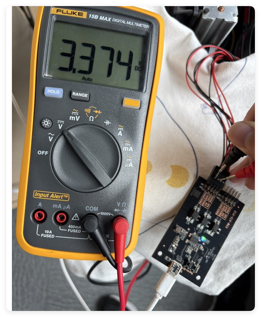

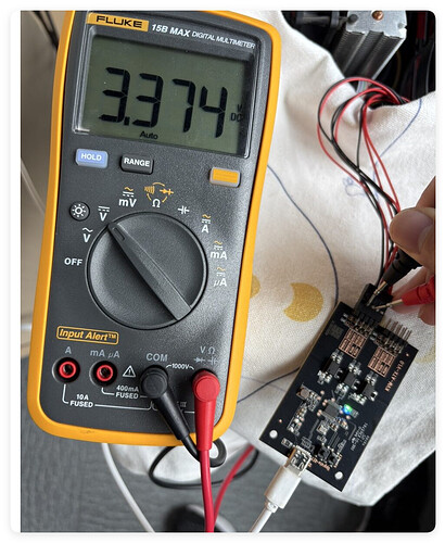

I set up the Comet with ATX Board in a modern PC and everything except sending power switch signals remotely via the Comet seems to work as expected.
I measured 5v across the Interface 4 PWRBTN +/- header pins, then measured it drop to 3.3v when sending a remote power switch signal via the Comet and GLKVM app on a controlling laptop. Of course, this is easier to see with the long press rather than the short press.

Could you please tell where the voltage you test? In my situation I got 3.3V at the head pin. when sending a remote signal it drops to 0V.
