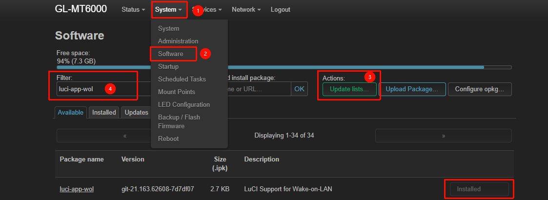

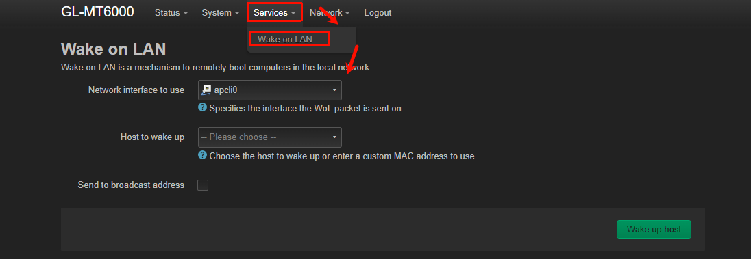

May we know why you want to configure static ARP entries?
If it’s to assign a fixed IP address to a device, please use the Address Reservation feature.
If you want to use WoL, please refer to the post below for installation and usage:

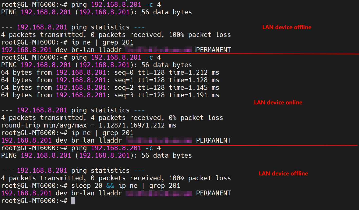

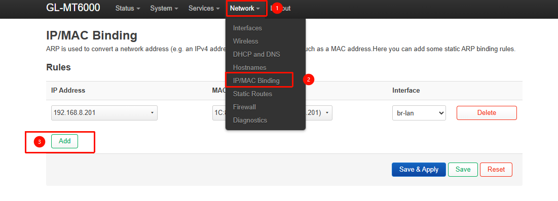

In that case, arpbind already has a ready-made Luci app available.
You can install and use it with the following command:
opkg update && opkg install luci-compat
wget https://immortalwrt.kyarucloud.moe/releases/21.02.7/packages/aarch64_cortex-a53/luci/luci-app-arpbind_1_all.ipk
opkg install luci-app-arpbind_1_all.ipk
Then configure it for use in Luci - Network - IP/MAC Binding and reboot to take configuration effect.

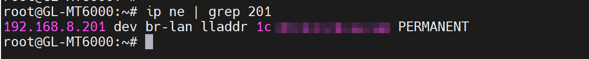

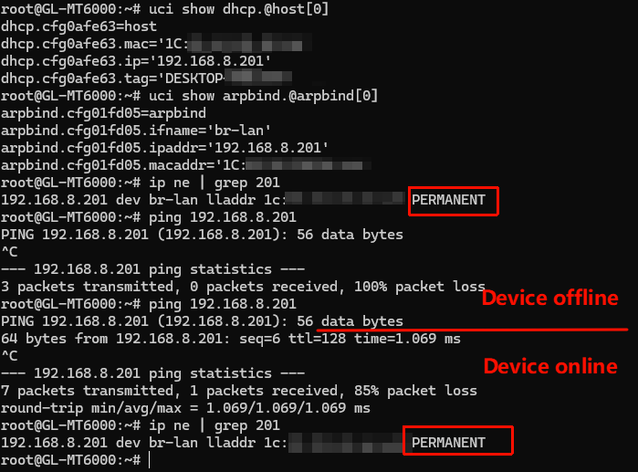

My local tests show that the corresponding ARP entry remains in PERMANENT state regardless of whether the device is connected or disconnected, or whether the router is rebooted again.

:thinking: It’s a bit strange, because no matter how we test here, it’s always PERMANENT.
This includes repeatedly connecting/disconnecting LAN devices like what you do.

Try adding a DHCP reservation—arpbind still works for me with that setup.
I’m not entirely sure why it isn’t working on your end. May need to seek support from the OpenWrt community or the original author of arpbind, since this plugin isn’t maintained by us.
