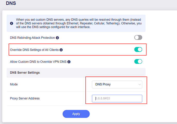

I have a rapberry pi 4 running Pi-hole on 192.168.1.20 on port 53.
I use this as a DNS server.
I would like to block port 53 for all other devices on the network.
When I enable "Override DNS Settings of All Clients" it also blocks the port 53 on my Pi-hole device.
What can I do?

What if you set this
Use the router to proxy dns to your pi hole.
So all dns request to port 53 is forwarded to the pi hole.

When DNS Proxy is enabled and Override DNS is checked, it doesn't work because the Raspberry Pi is on the local lan...
