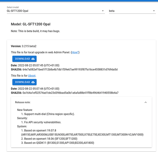

First, pls upgrade firmware. You are using an older firmware because it is 18.06.
Second, you do not need to remove wpad-mini because in our default firmare we have wpad already.
