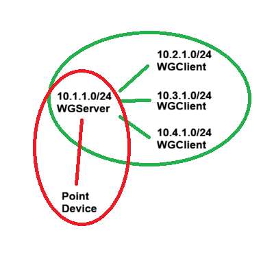

I have a network configuration as shown below.
Sorry if this is redundant but all I could find seemed to address site to site.
My Site to Site and Client to Client connections (green) all work perfectly as one big network. My problem comes in when I connect a Wireguard Point to Site client.(Red) (Android or PC) I can only see the WG server LAN at 10.1.1.0/24. It is totally blind to the other clients LANs. My Config file for my point clients looks like this:

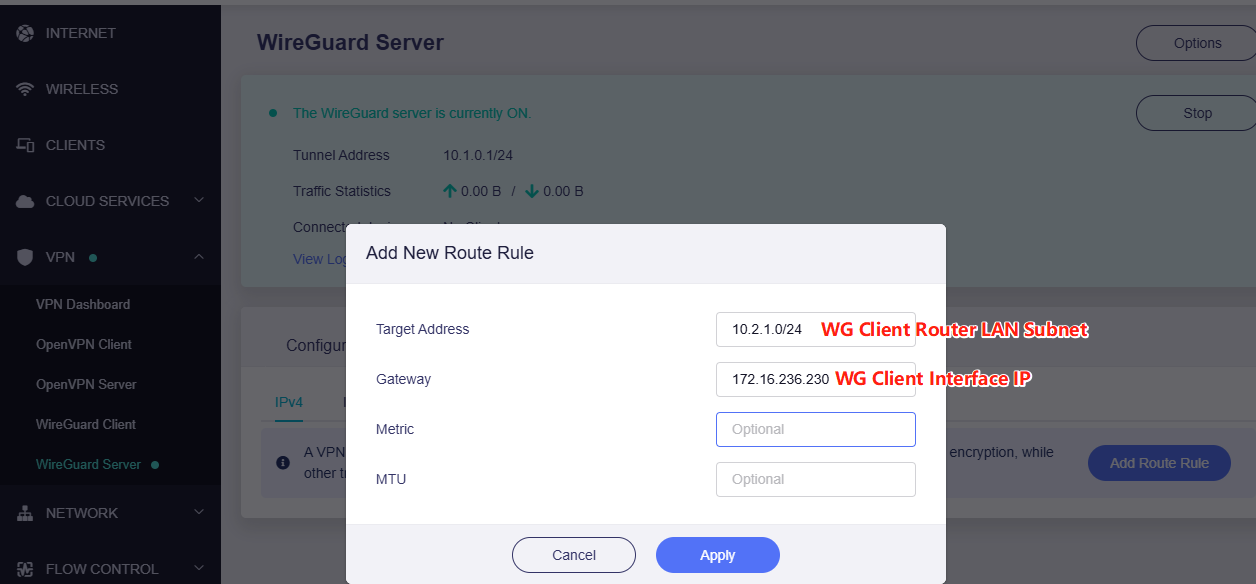

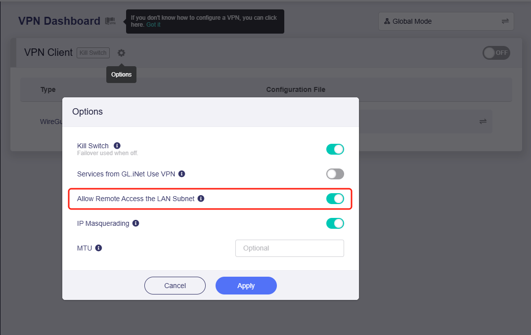

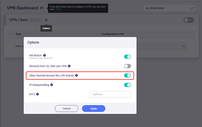

There may be two reasons: WGClient is not allowing access to its LAN subnet, or the WGServer is missing route rules.
  1. On the WGClient (for example 10.2.1.0/24), enable "Allow Remote Access to the LAN Subnet"
  2. On the WGServer (for example, 10.1.1.0/24), please manually enter the routes, for example:

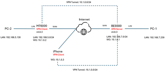

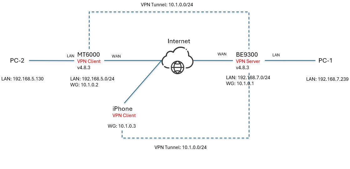

I get it now. The red circle marks a point device (PC or phone), the green circle are some routers. The routers in the green circle can access each other's LANs without issue, but that red-circled PC/phone is unable to reach the WG client router's LAN clients.
I set up an environment to try to reproduce this issue, but they work properly, the phone is able to access the WG client router's LAN client (PC-2).
Topology:

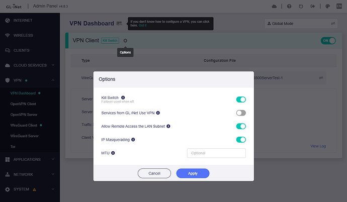

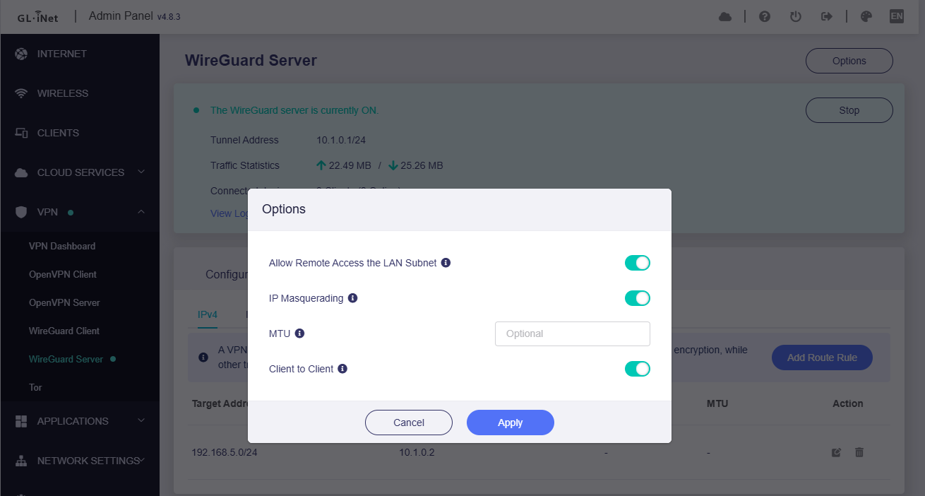

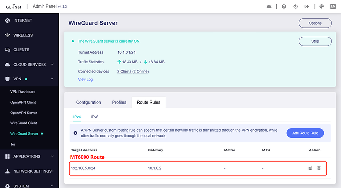

BE9300 WG Server configurations:
MT6000 WG Client configurations:

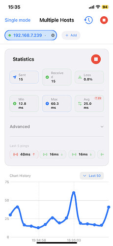

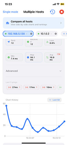

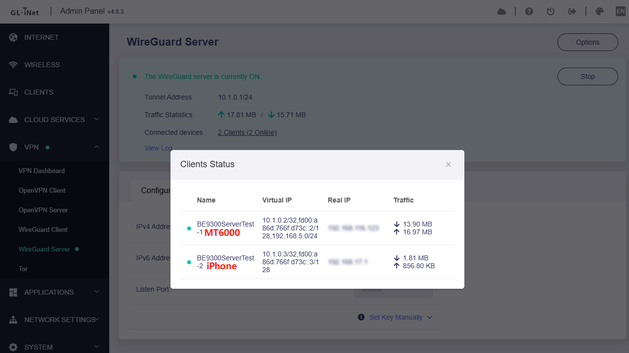

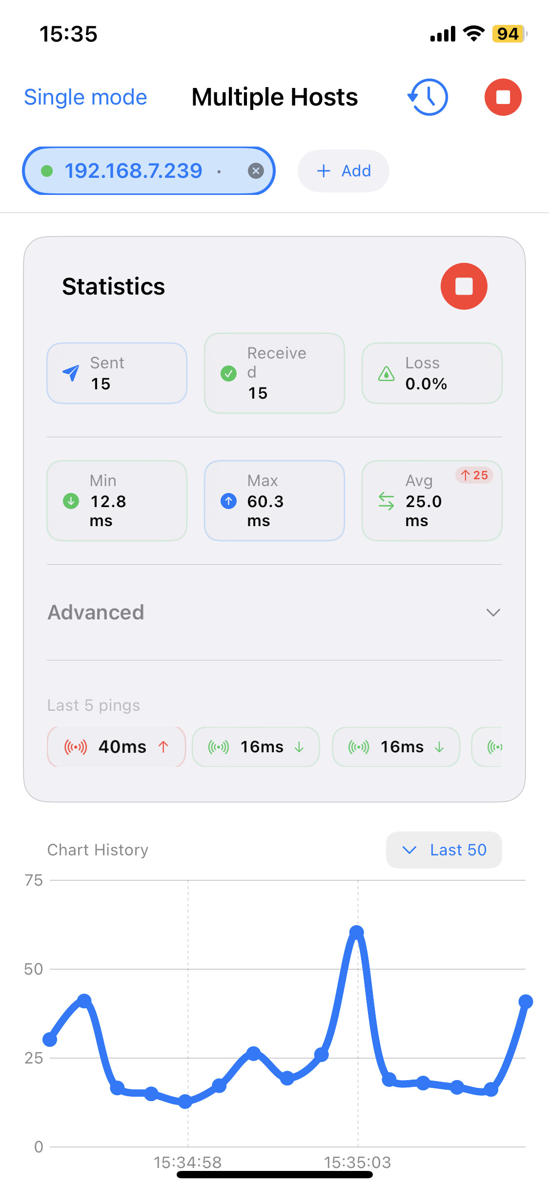

Verification on phone:
iPhone -> PC-2
iPhone -> PC-1
Do you have any configurations that are different from mine?
The only thing I see different is IP Masquerading......... I have mine off....
It seemed to break things when I turned it on so I never really fooled with it.
The network was working fine so I didnt see the need but that may be it...
The phone si probably showing up directly in the tunnel with no lan IP.
If IP Masquerading (WG client or WG server?) is enabled, would the point device be able to ping to the (WG client) router LAN client?

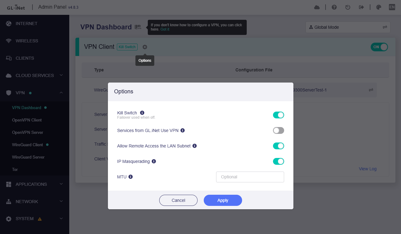

In firmware v4.8.x, the VPN dashboard features updated/changed some policies:
the VPN client no longer support AllowedIPs in the profile. You need to change the AllowedIPs in the VPN client’s profile (BE9300-Client) to 0.0.0.0/0 and save.
And, input the AllowedIPs into the to list on the VPN dashboard, to enforce which destination IP or subnets should go to the VPN tunnel.

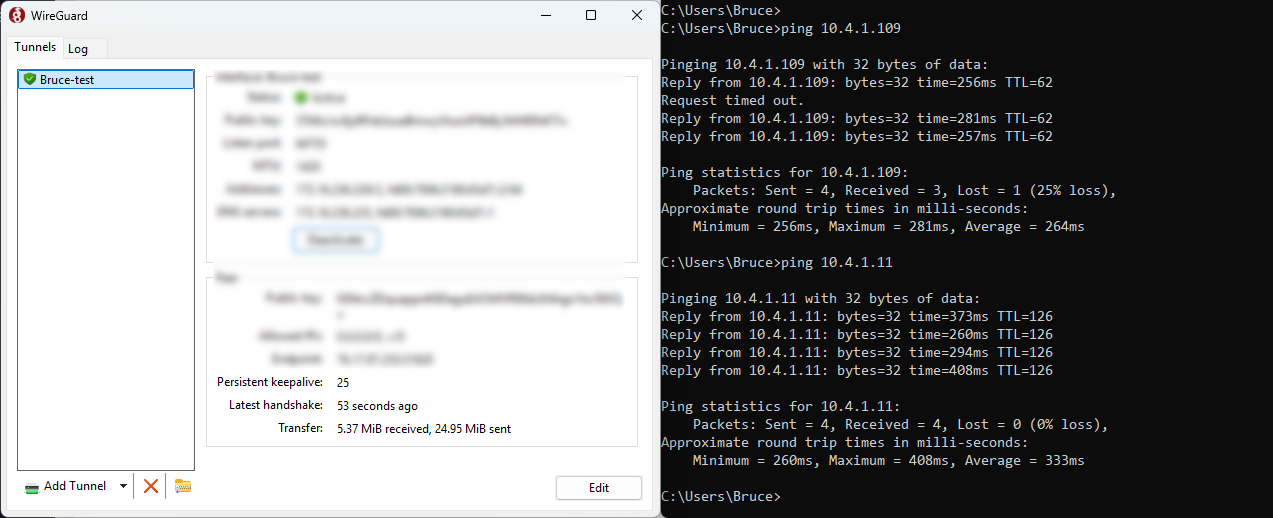

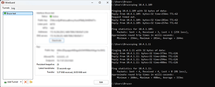

I temporarily created a profile on the VPN server (BE9300-Server), only to verify whether the point device be able to access the VPN client (BE9300-Client) LAN devices.
My PC connected to the BE9300-Server and verify it, it works properly:
After verification, the temporary profile was removed.
