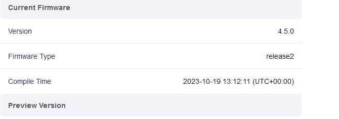

OK…Today I spent significant time testing with openwrt-ax1800-4.5.0-1019-1697723253.tar which is the Release 2 dated from 10/19.
What I decided to try first was just loading the new firmware and not keeping any settings…After the upgrade and confirmed I was on the new firmware…I set the TimeZone and nothing else…I then tested to see if I could make a call with the OOMA Telo VOIP device…I could. I could make and receive calls without issue. OK…Now to start configuring manually settings one by one and testing. The OOMA Telo continued to be able to make and receive calls. NOW…Let’s try adding VPN back in…I configured both OpenVPN and Wireguard Connections. I made sure to set the VPN Policy based on CLIENT DEVICE and I made sure to have the OOMA Telo MAC ADDRESS was set to NOT use the VPN. First thing I tested was WIREGUARD…Can I make a call?..NO!!! Once the Wireguard client was enabled calls would not go through (Outgoing or Incoming) even though the OOMA Telo MAC Address was set to not use the VPN…OK…Let me disable Wireguard Client. I found I had to reboot the OOMA Telo in order to be able to make and receive calls again after the Wireguard Client had been disabled. I then tested the OPENVPN Client…Will it make and receive calls with OpenVPN? NO…Once the OpenVpn Client was enabled I could not make or receive calls. I had to disable the VPN client and then reboot the OOMA. Once the OOMA was rebooted I could make and receive calls again but ONLY WITH NO VPNs ENABLED on the FLINT router. So with the openwrt-ax1800-4.5.0-1019-1697723253.tar Release 2 dated 10/19 Firmware the OOMA Telo will make and receive calls but ONLY with No VPNs Enabled. Hope this helps.
