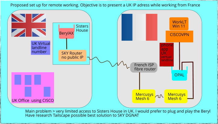

I intend to set up a (and you will forgive my ignorance with terminology) a tunnel between France and the UK so my wife can work remotely in France while providing her employer with a UK IP address. I know, I know!
I am proposing to use the set up shown in the diagram. Proposing because Im clueless (advice appreciated), so far I have only ordered the Beryl. I’ll be doing all the set-up from France if possible as access to the UK is difficult and my wife (who will be doing the final installation in the UK is even less literate than I am.

Is there a way to overcome SKY DGNAT if I don’t have a real public IP address in the UK (I’m thinking of using Tailscape if that’s the case)? Does Tailscape present a UK IP address ?
How can I ensure a minimum amount of configuration for my wife when she installs the end node (Beryl) with ethernet cables to the SKY router ( fibre white) back in the UK when she next visits?
Am I barking up the wrong tree ? Is there a better way?
That’s it for now, plenty more to find out, but if there's no solution, I’ll have to look elsewhere.
If you want to connect a GL router behind SKY modem in the UK and act as a VPN server, you must confirm whether the ISP provides the public IP to Modem or (Modem bridge to) router WAN port.
If you own public IP, I think you can easily configure it by referring to the following video or docs.
If there is no public IP, you can use AstraWarp, Tailscale, etc. to form a virtual network and use the IP from your home in the UK as the exit node. I think it will be safer and less likely to detect than VPN public service providers.

Hello, thank you. Is it possible using Tailscape to create VPN to simply plug an ethernet cable between Beryl WAN and the SKY hub LAN without having to change any settings on the SKY router? Looks like SKY are using MAP-T where a public IP is shared between local users.
One public IP is shared between local users, so in fact we don’t own this public IP, and can’t use it to do anything, such as building VPN server/Web server and other services that can be accessed by the public Internet.
You can enable Tailscale on Bery and set it to be hosted the exit nodes.
On other devices (remote), enable tailscale and select Beryl as the exit node.
