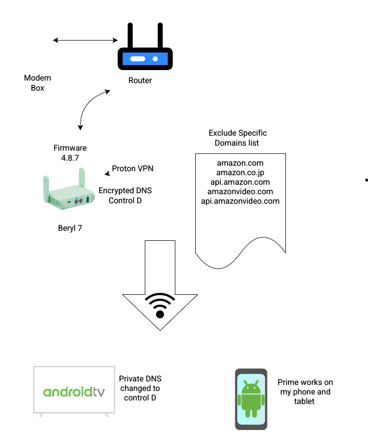

I have Beryl 7 on firmware 4.8.7 connected to router that's connected to modem.
I'm using Proton VPN on wireguard + ControlD as my encrypted DNS. I have allowed custom DNS to override VPN DNS.
I can't get Prime to work on Android TV because it detects my VPN, even though I have excluded Domains. It works on Android phone and tablet.
Any suggestions to how I can get it work on Android TV?

I don't want exclude the device because there are things I want to be on VPN connection.
I tested for dnsleaks, however only 1 server found and that the ControlD one.
Running ipv4, but did try ipv6.. no luck
Just weird nothing happens on my other devices running Prime with the same setup.
I don't want to use the VPN for prime, so I had hoped it could be bypassed on the router.
