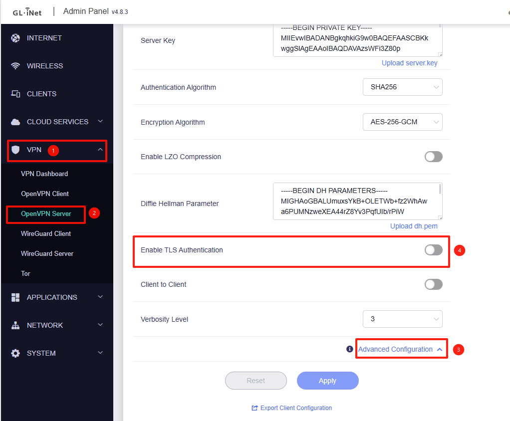

Also, the GL-iNet OpenVPN config contains a TLS-auth 2048 bit OpenVPN static key that my ASUS Openvpn client config doesn’t have. (Nor, incidentally, does the client config for the OpenVPN server on one of my NASs). Is there some way to exclude this from the server and client?

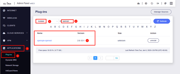

Also, I can find nothing mentioning what release of the OpenVPN server is in MT6000. I know there were some significant security changes to OpenVPN within the last couple years and I would like to know if the are included in the MT6000. Some supported encryption key formats were added and deleted.

Regarding the TLS issue, I don’t want to disable it. My client other router’s VPN config file contains the statement “remote-cert-tls server”. I think that meant the TLS certificate is included as a field in the server’s certificate. If I could import that other router’s server certificate then maybe I could get my old config files to work.

Interesting. openvpn-openssl was not showing with the “Installed” filter. I guess because its status was “Update” (update from 2.6.12.-r1 to 2.6.14-r2). Once I did the update it showed with the Installed filter.
While technically true that its status was not “Installed”, the plugin was installed and should have been listed as such.
Currently, we are still discussing with the R&D team how to improve the handling of custom certificates in OpenVPN Server mode.
Theoretically, once you have imported the CA certificate, Server Key, and Server Certificate on the server side, you should be able to connect using an existing client configuration file by simply updating the server's IP address entry.
However, the "Export Client Configuration" feature on the router will remain unavailable in this scenario. This is because the CA Private Key is not present on the router, making it impossible for the router to sign and generate new client certificates.
Since the OpenVPN Sever configuration files are generated in real-time by the GL.iNet Admin Panel, the manual modification method won't work in this specific case.
However, you can consider installing luci-app-openvpn and use luci to achieve this.
