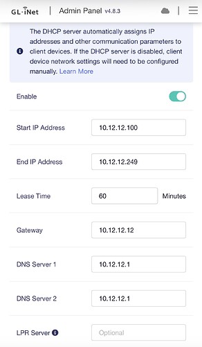

I have setup custom LAN DNS to point to a Raspberry PI running AdGuard Home.

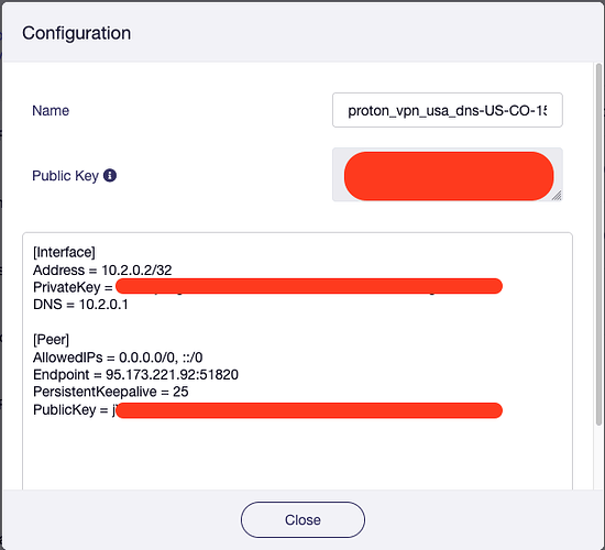

When connecting to Proton VPN with a device, the DNS stays as the Raspberry PI/AdGuard Home DNS Server, and does not change the the Proton VPN DNS Servers.
I need to be able to use Proton’s DNS Servers for streaming services to work correctly as it doesn’t like it when a custom DNS is used, rather than Proton’s own.

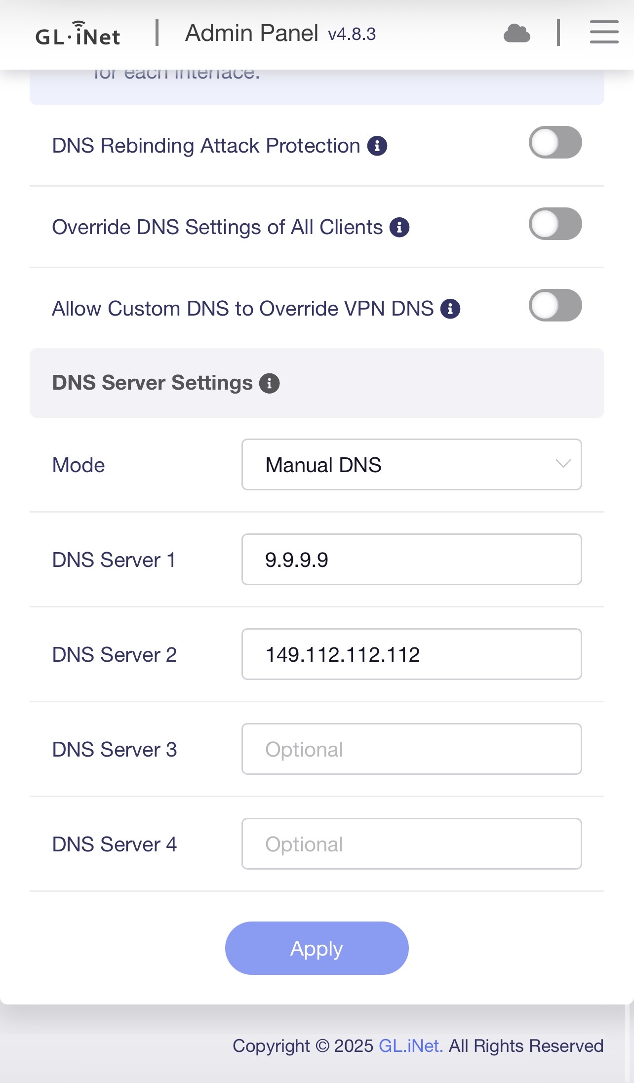

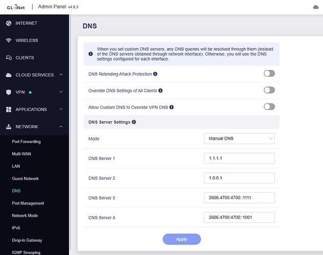

Go to be to Network > DNS and disable:
Allow Custom DNS to Override VPN DNS

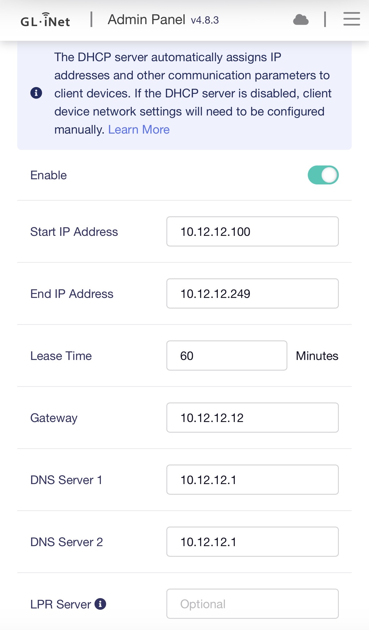

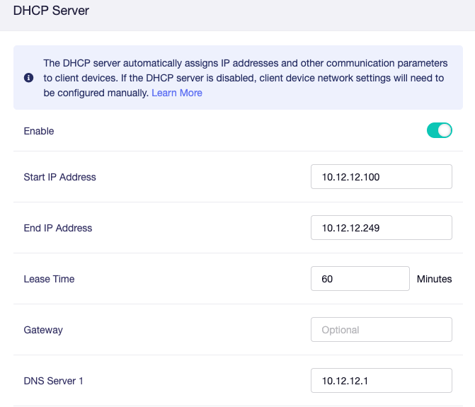

This is already disabled - note the custom DNS is set at the LAN/DHCP level, not the WAN DNS settings (as per screenshots).
I am using a Raspberry PI as historically I have always used it - plus it is running Unbound for DNS.
I don’t want to have to setup client settings, blocklists, custom filtering rules etc. again.
It appears the LAN DNS setting overrides all other DNS settings, including those used by VPN Clients.

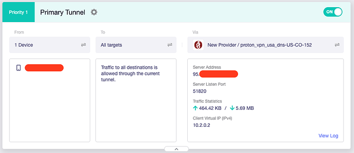

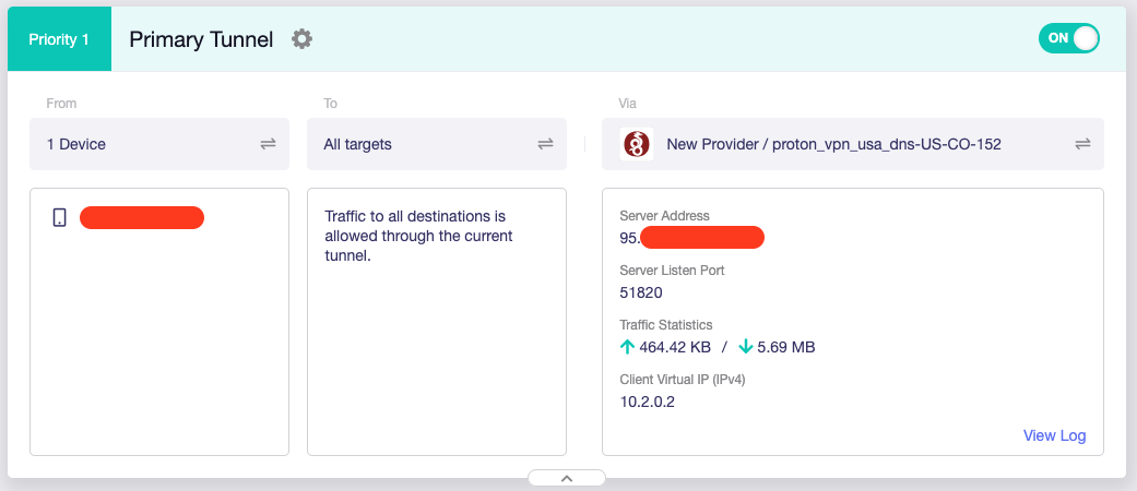

Note this is only happening in Policy Mode when specifying individual clients - when set to Global Mode, all traffic (including DNS) is routed over the VPN as expected.

When DNS is distributed through DHCP, LAN devices send their DNS queries to the Raspberry Pi.
The Raspberry Pi then forwards those queries over the WAN interfaceto the configured DNS servers, since it is not included in the VPN policy.

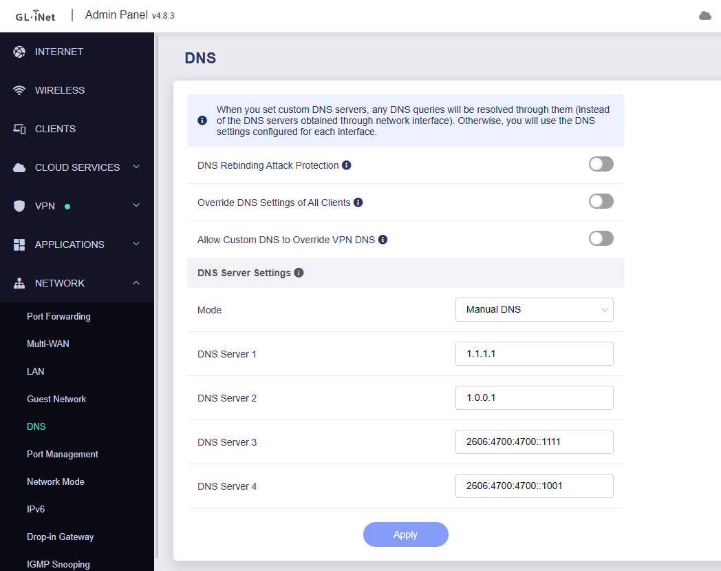

If you want devices in the VPN policy list to use the VPN DNS while others use the Raspberry Pi’s DNS, please follow these steps:
  1. Remove any DNS servers configured in DHCP so that all LAN devices use the Flint 2 LAN IP as their DNS resolver.
  2. In Network → DNS, configure the Raspberry Pi’s LAN address as the manual DNS server (Cloudflare DNS is used here as an alternative).
  3. Disable Allow Custom DNS to Override VPN DNS.
Configuration:
Test results:

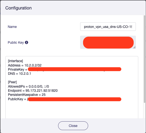

The VPN DNS would not work with your settings been shared as well.
This should only work if "Override DNS Settings of All Clients" is enabled or if your VPN provider intercepts and rewrites unencrypted DNS requests.

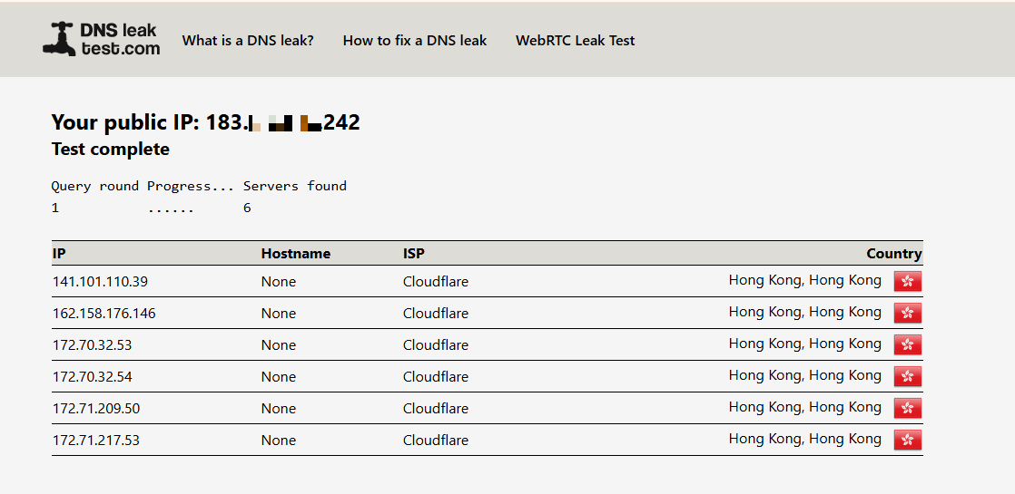

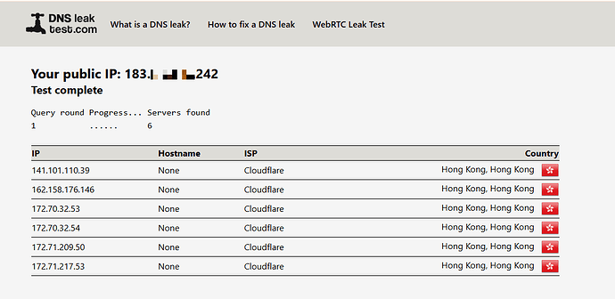

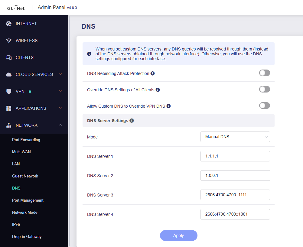

Test Configuration:
Verification:
DNS queries of LAN devices are transmitted via the VPN tunnel and adhere to the DHCP DNS settings.

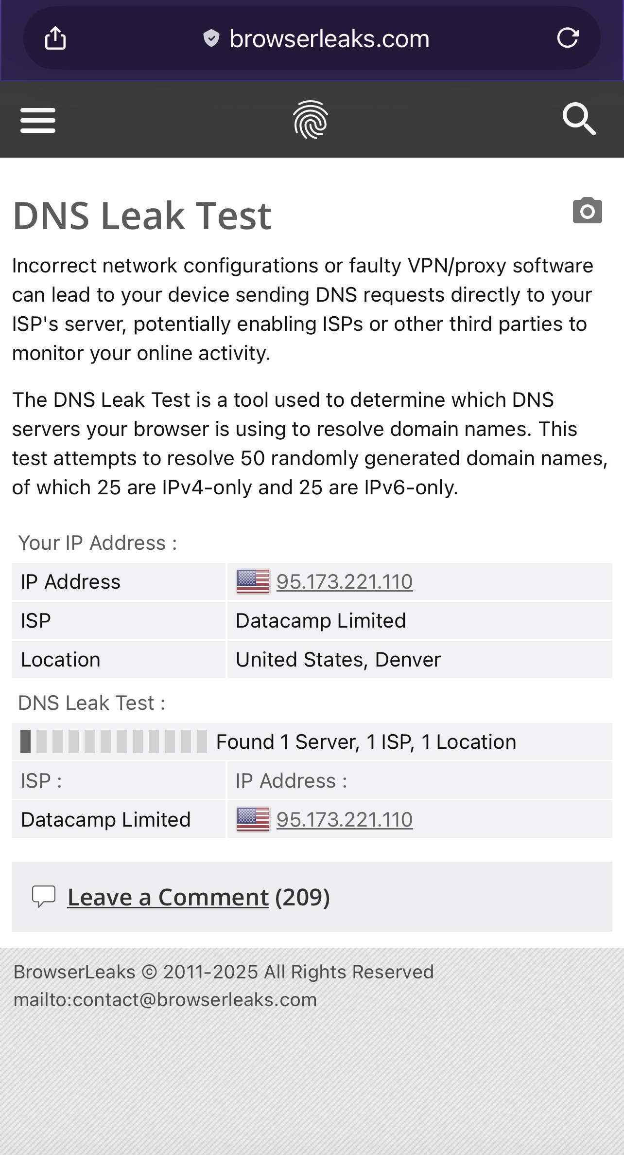

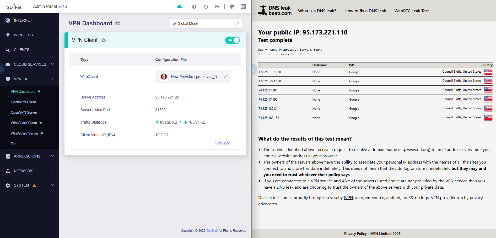

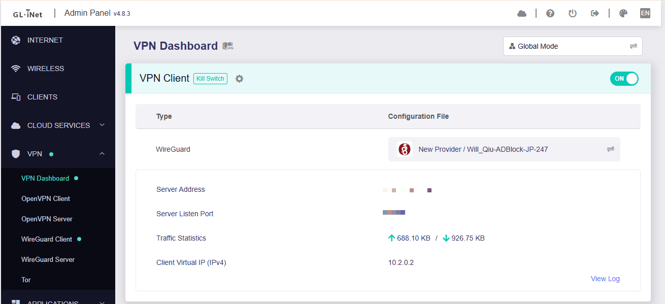

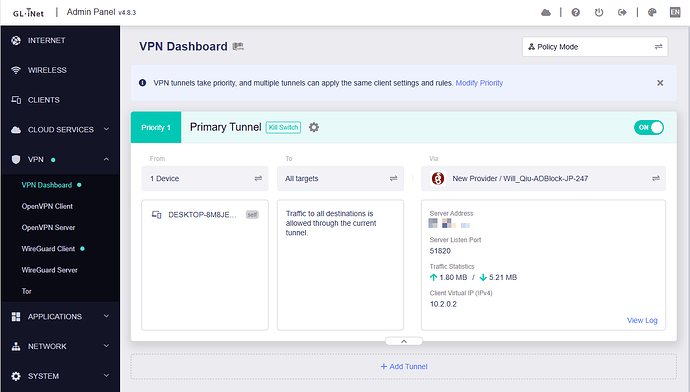

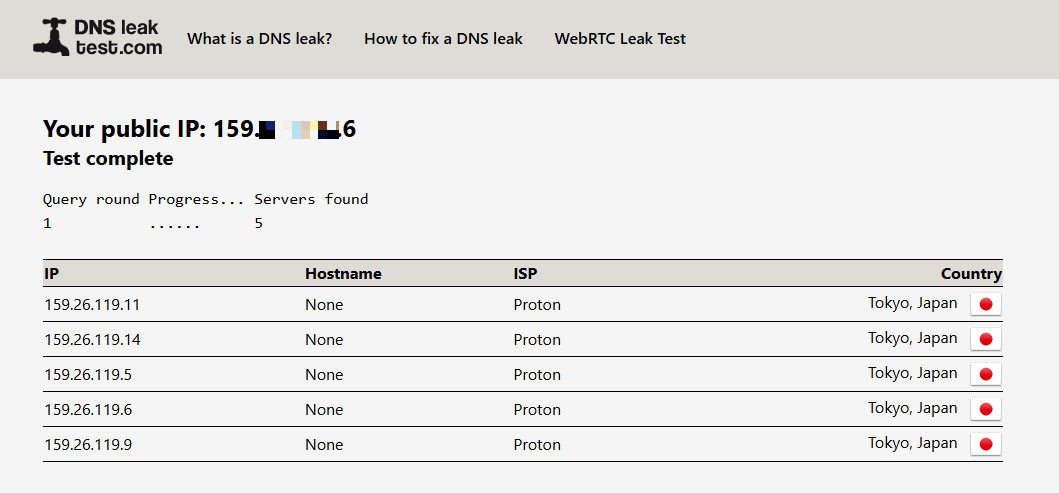

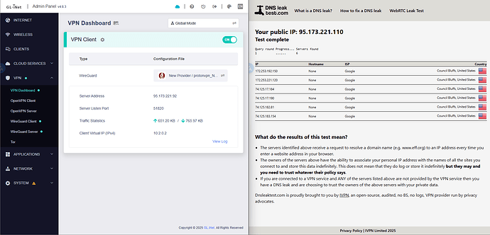

Here we go - these are the results using Global Mode with the exact same DNS settings when using Policy Mode.
As you can see, the LAN DNS is overwritten with the VPN DNS Server, which does not happen in Policy Mode selecting an individual device or devices.
No additional settings are enabled per the screenshot.

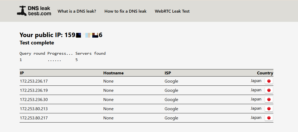

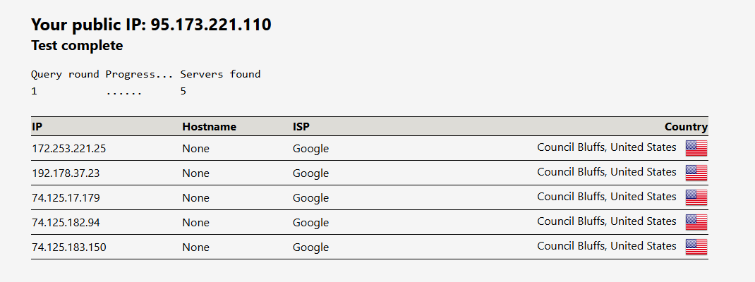

That's strange — we haven't been able to reproduce this issue on our side.
We replicated your setup as closely as possible, including the VPN server configuration, with the only difference being that our LAN DHCP assigns Google DNS.
However, the DNS leak test still correctly reports the Google DNS provided by LAN DHCP.

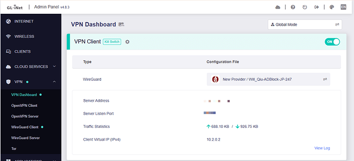

We have exported your router configuration and imported it into our test device for a 1:1 comparison.
So far, we have been unable to reproduce the issue: in global mode, all clients' DNS requests follow the DNS settings provided via DHCP, regardless of whether they are connected via Ethernet or Wi-Fi.

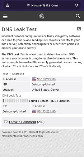

That makes sense.
In global mode, the VPN DNS is still not being used.
It's just that your Unbound is using the VPN IP as the exit point to access the DNS leak test's authoritative DNS server for the address—so the DNS leak test shows the VPN IP address.

At present, you can force all LAN clients’ unencrypted DNS traffic to be redirected to the router by enabling Network > DNS > “Override DNS Settings of All Clients” option.
When “Allow Custom DNS to Override VPN DNS” is disabled and the VPN is enabled, the system will use the VPN’s DNS as intended.
It does.. yes…
But then all LAN traffic gets redirected to the WAN DNS (which is set to Quad9) and bypasses the RPi DNS altogether - which is not what I want.

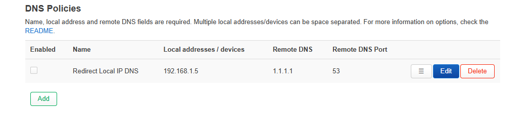

This is how the Merlin firmware for Asus implements PBR for VPN clients: Policy based routing · RMerl/asuswrt-merlin.ng Wiki · GitHub
As a side-note this is how it implements DNS redirection in general - allowing for selective DNS redirection for clients (ie routing some clients to LAN, some to WAN, or some to a whole other specified DNS provider)
Oh, so this functionality is provided by Asuswrt-Merlin rather than the stock ASUSWRT firmware.
If you have experience with advanced third-party firmware, you may consider installing and configuring luci-app-pbr, which can offer part / similar policy-based DNS routing behavior. But please note that this falls outside our official support scope.
