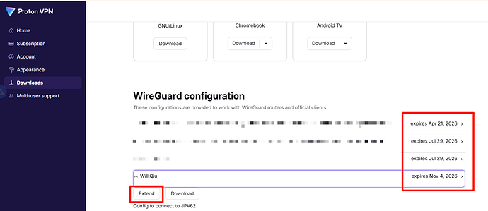

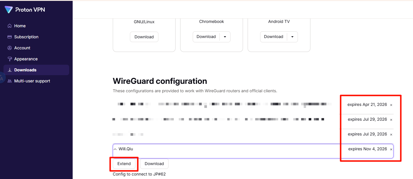

We conducted local tests using MT3000 (v4.8.1) and MT6000 (v4.8.3) and were unable to reproduce the reported problem.
Please note that the certificates in Proton’s WireGuard configuration files have expiration dates.
We recommend checking the Proton official website to confirm whether the connection failure is due to an expired key.

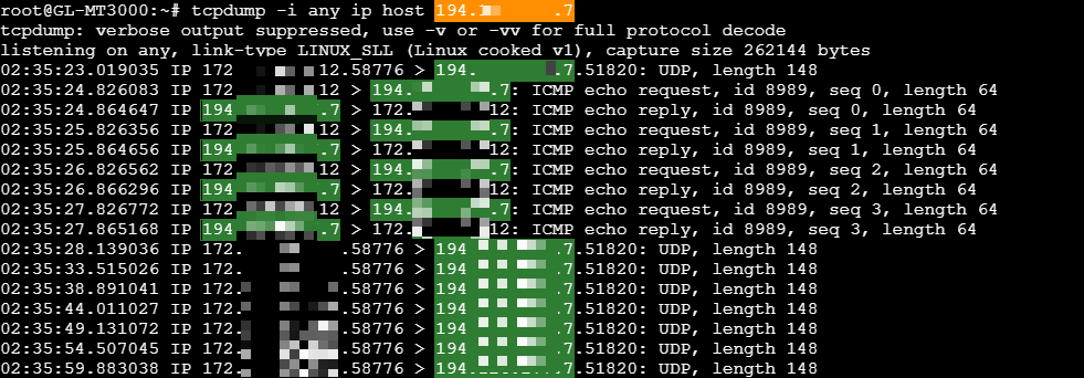

Based on our inspection, it looks like your network is blocking the WireGuard protocol.
The packet capture shows UDP/WireGuard traffic is being dropped, while ICMP to the server still works.
The WireGuard log shows a REKEY-GIVEUP error, which indicates the tunnel failed to rekey because the peer never completed the handshake:

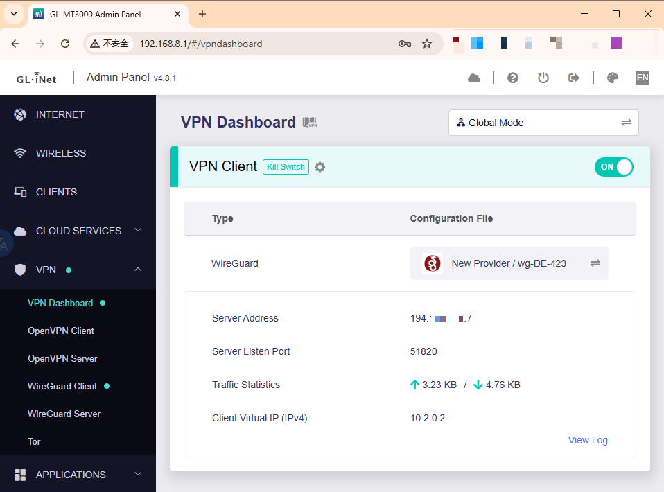

The same WireGuard config works locally on our MT3000 (v4.8.1), so the issue may be specific to the network.

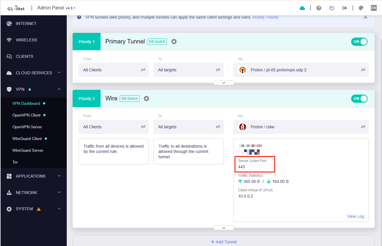

Meanwhile, another profile using port 443 is functioning properly on your router—meaning the firmware's WireGuard can operate normally.
