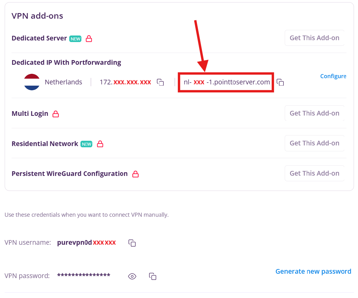

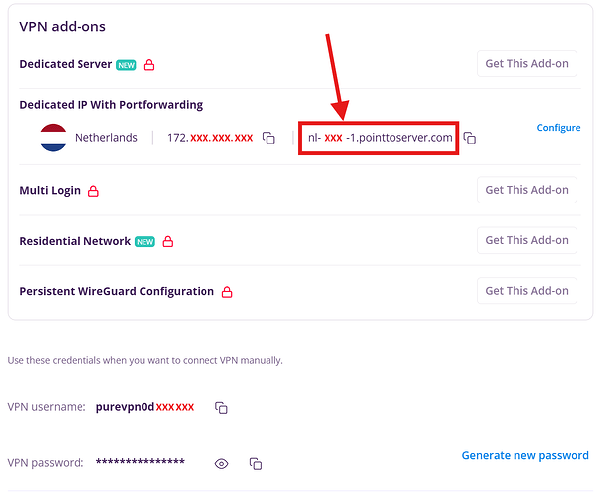

With the Dedicated IP + Port Forwarding package, you are given both the static IP AND a DNS address viewable by clicking “Subscriptions” in the left hand navigation pane on their site.
See attached image for what the Subscriptions page looks like. (I’ve redacted my details here in red).
Step 1) Click “Subscriptions” on the left. Make a note of the DNS address shown.
