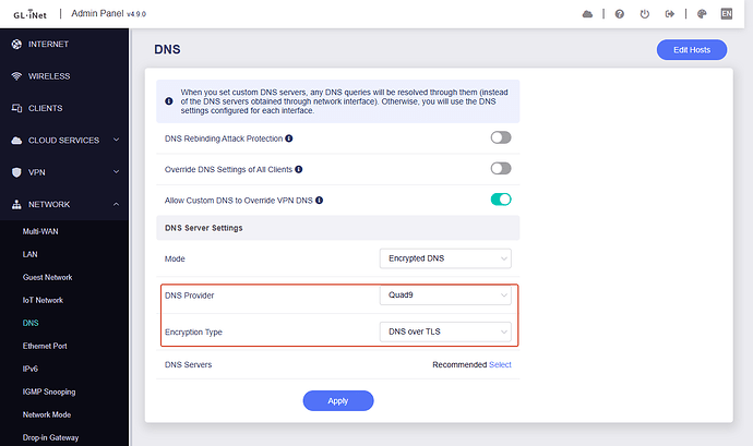

May I know if you need DoT support for Quad9?
If yep, it will be supported in the v4.9 firmware. Please wait for the firmware update.
