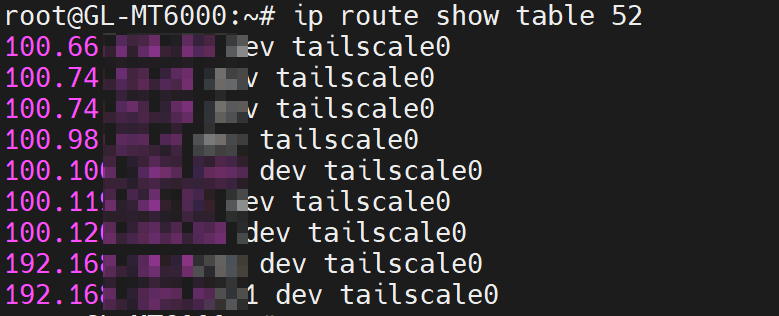

Thanks
On Location B was a second IP Adresse
Can someone explain to me why this works?

I can reach the IP address 192.168.1.3 at location B.
Why does the Flint2 route this traffic via Tailscale rather than through the regular internet connection?
There is no entry for this in the routing table.
