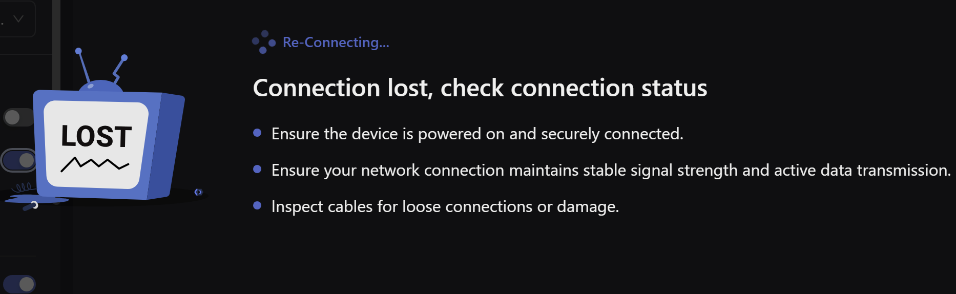

Reconnecting takes long time or stuck on reconnecting
The application experiences significantly long reconnection times in two scenarios, making it faster to manually close and restart the connection.
Scenario 1: Manual Microphone Toggle
  • Trigger: Turning the microphone off during an active session
  • Expected Behavior: Quick reconnection to resume the session
  • Actual Behavior: The active session initiates reconnection, which takes a long time
  • Workaround: Closing the window and manually reconnecting is faster
Scenario 2: Connection Interruption
  • Trigger: Connection interrupted due to network lag or other connectivity issues
  • Expected Behavior: Automatic reconnection within a reasonable timeframe
  • Actual Behavior: The app gets stuck on "reconnecting" status
  • Duration: Exceeds 10 minutes of waiting time
  • Workaround: Forced to close the window and manually reconnect

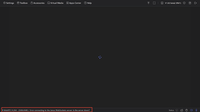

I also get this error when using GLKVM app. My client is connected by WIFI to the same router as Comet:
another error:

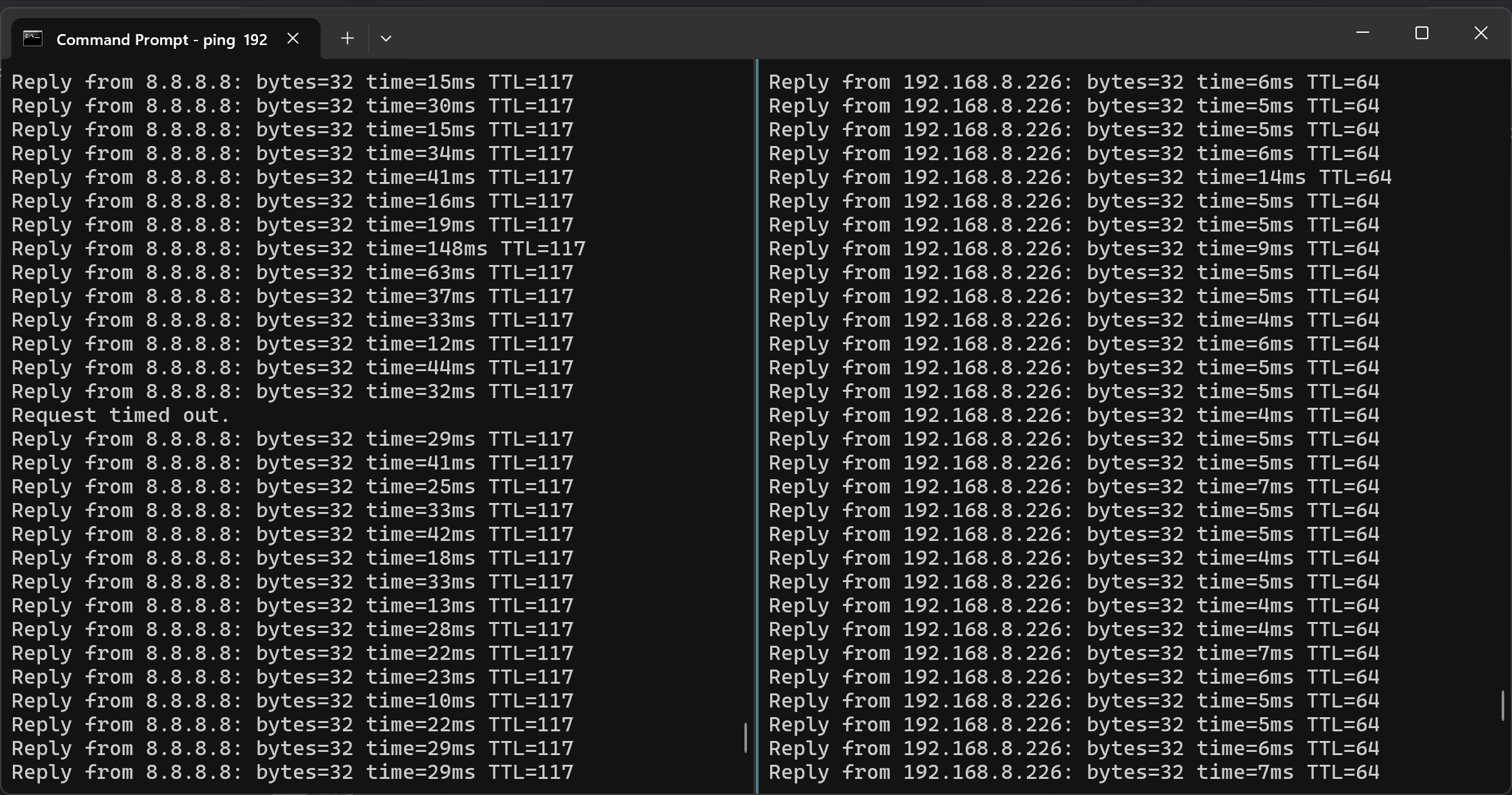

here are my pings:
My network seems to be good. Occasionally I get some request timeout while pinging google IP, but it’s not affecting the stream as i have noticed. When pinging local network i don’t get request timeouts.

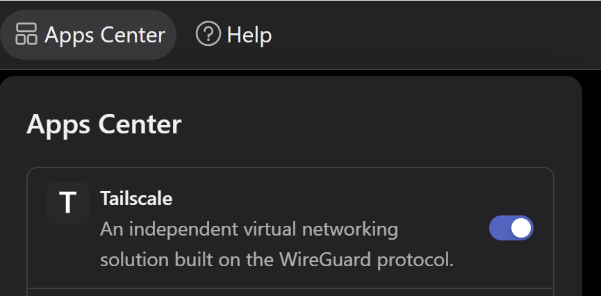

I switched to another virtual network provider (Tailscale) and problem disappeared.
