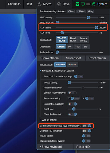

You can enable the PIKVM UI and turn on the switch mentioned in the ISSUE. The reason I didn't add this button on the page is that it might increase some cognitive load. However, I have to admit that there isn't a particularly good solution in the short term.
Feature Request: Add an Advanced Settings Mode in GLKVM to Expose All PIKVM Options · Issue #13 · gl-inet/glkvm
How to enable the pikvm ui.
Also any alternate way to switch on off this switch via a console command that is persistent after reboot. I prefer the comet UI
The link in my reply provide the method .
You can have a try and give us feedback.
If you need detailed instruction, feel free to let me know.
@poe9187 I have send you a private message of intruction.
The above is very helpful and works. Can you please include this in your UI also as it is important and an important use case for comet wherein the device is accessed from somewhere where the internet quality may not be very good.
I'm not entirely sure why PIKVM doesn't enable this by default if it actually resolves the issue. I'm concerned it might introduce other complications. If you could help verify whether this switch might cause other problems, that would be appreciated.
It did not cause any other issues. Perhaps not enabled by default as only required if latency/ jitter is high.
It will be good to have a toggle/ button to enable/ disable this in the comet ui like in pikvm.
Will be added in the future release
Is this incorporated in the new release. I don't see it.
This is an excellent option and I again tested it by activating the PiKVM menu and it works very good. Is there a way to change it using a Linux command so that I can keep using the comet web interface.
Also please incorporate it in the new version
You can open two UI interfaces simultaneously. Opening it in PIKVM UI should also work in GLKVM UI.
Understand but that's a temporary solution.
Why not add this bitton to your menu? It is very useful.
You can have a section with advanced settings and some of these features.
It will be added, but the next version is a month away.

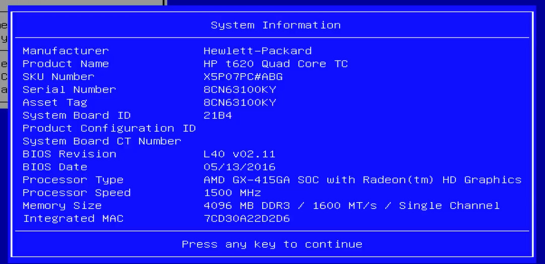

I am getting duplicate key presses in the bios and weird behavior with arrow keys at the debian login.
I have tried all the ideas I have found in this thread and other PiKVM threads.
I tried connecting to it from a linux machine and a desktop machine in firefox, chrome and edge.
I also tried using the virtual keyboard and the physical keyboard and have the same behavior with both.
I have changed all the suggested settings in the PiKVM dashboard and the GLiNet dashboard.
Nothing has made any difference to the duplicate key presses in the bios and the random characters displayed when using the arrow key at login.
I am connecting to a HP t620 thin client.
