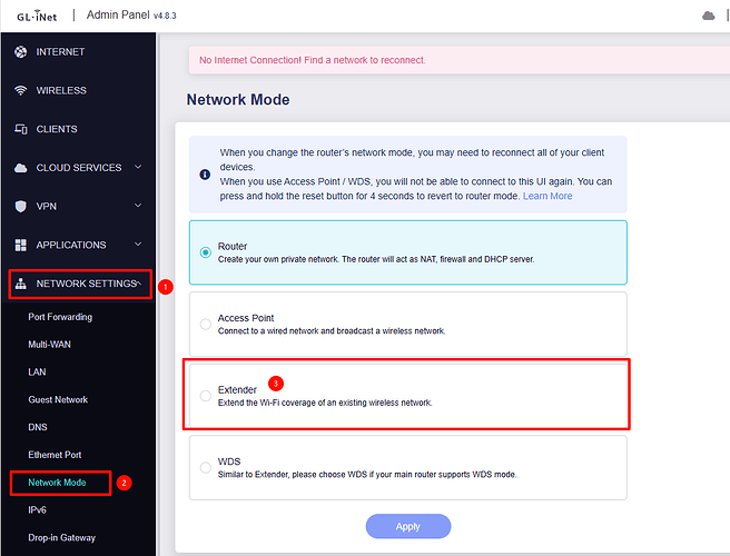

Regarding your requirements:
  • If the camera does not rely on Layer 2 connectivity, we recommend configuring the Beryl AX in Repeater mode to connect to the 5G backhaul. Then, connect the camera to the Beryl AX’s 2.4 GHz Wi-Fi.
  • If the camera does require Layer 2 operation, you may consider to use the Extender mode.

Have you had a chance to test Extender Mode as previously mentioned?
When operating in Extender Mode, the Beryl AX should relay to the Slate 7 network, so all clients — including cameras — obtain their IP addresses from the Slate 7 DHCP server and remain in the same Layer-3 subnet.

Thank you for updating your configuration.
Could you help clarify our earlier question—have you already tested Extender Mode?
You can enable it in the Admin Panel under Network > Network Mode.
Since many custom LuCI rules are currently applied/been tested, we recommend performing a factory reset before switching to this mode to avoid configuration conflicts.
If you have tried it but it did not work as expected, please let us know the outcome.
Additionally, could you describe how your camera is intended to operate?
For example, does the app require you to manually enter the camera’s IP address, or does it rely on automatic discovery within the network?
