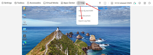

Cannot export log files, every time I click Export Log Files the browser crashes.

  2. Could you try exporting the logs via the GLKVM App instead of the browser?

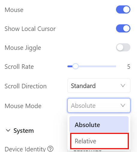

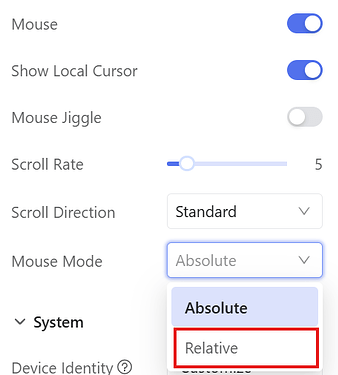

Regarding the mouse not showing up:
Please try switching the mouse mode to Relative and see if that brings back the cursor.
Changing mouse modes does not resolve the issue. And even then, I only have about a minute before the connection drops.

As far as logs, I cannot get the logs to download at all regardless of app or browser.
