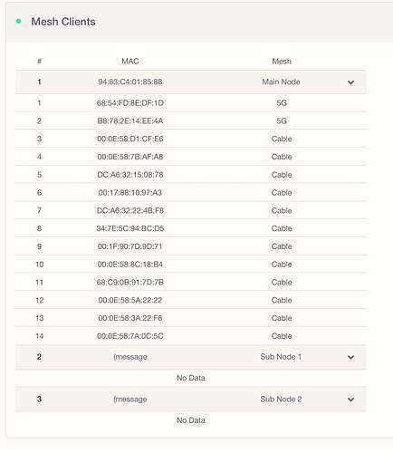

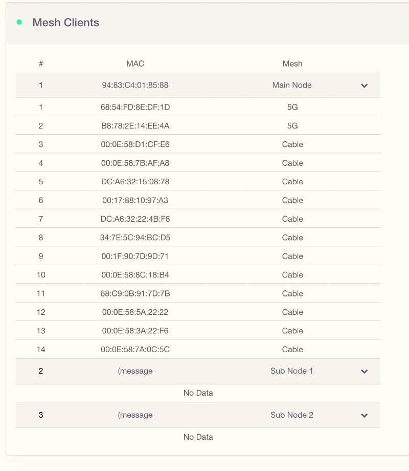

After updating the software to version 3.105 I also notices the mesh devices started showing ‘no data’, not sure if thats got something to do with the problem or not.
