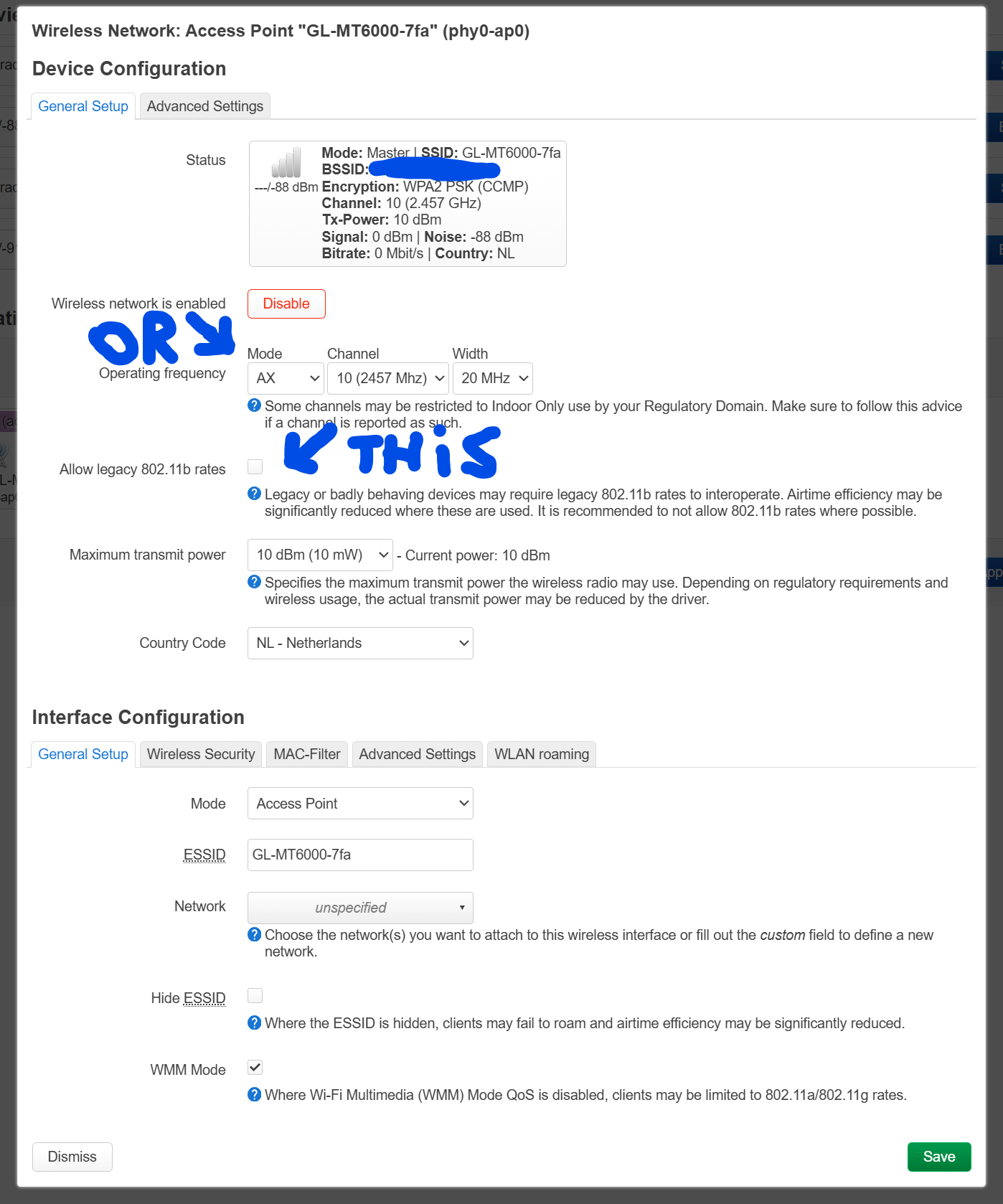

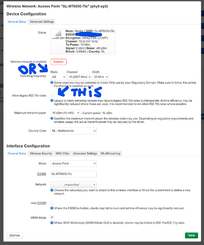

There are a few things you can try:
  • the easiest one is forgetting the network for the chromecast and re-enter it, some devices are buggy it is recommend to also avoid the use of wpa+wpa2 mixed or wpa3/wpa2 mixed cipher variants those mixed ones tend to break alot, you may choose wpa2 fully for the max device stability rather than wpa3.
  • you can go to advanced settings and visit luci and then go to network -> wireless and edit the band where you got issues with.
    then proceed to click advanced settings and uncheck Disable Inactivity Polling
    Restart router afterwards.
  • for very old devices, and I only seem to see this on older nintendo consoles you may choose the legacy rate bands option in luci, this will make your wifi mega slow but this is also for very old devices generally.

you could try:
that checkbox can make your wifi very slow though, but for extremely old devices this can be recommended.
with the other one you can try downgrading to AC or N, again this will downgrade speed capabilities.
are you sure you use 2.4ghz and not 5ghz?, make sure width is not set to 40.
also another thingy is that when changing cipher encryptions, it is very usefull to forget the network on client devices because sometimes they will not acknowledge any new key and are basicly stuck.
what also can be a issue is the channel, if you use a app on Android like wifiman, or wifianalyzer you can find a better channel.
also a word about stream especially the iptv/igmp ones:
since wireless is half duplex, it will have troubles with multicast so in order to solve this, is to turn multicast into unicast.
this setting can be found under the advanced settings tab in wifi.
