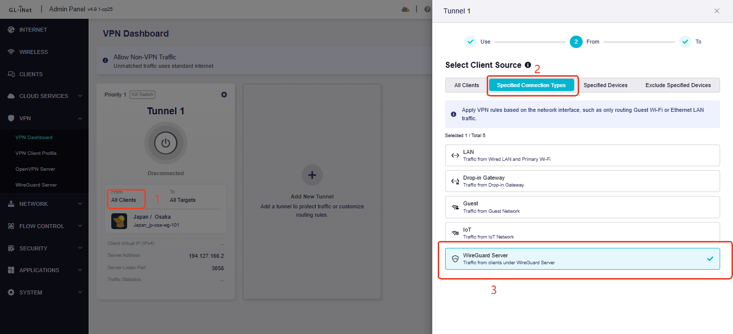

  2. Then go to VPN → VPN Dashboard, create a new tunnel using this VPN profile, and configure the traffic source as:
    From → Specified Connection Types → WireGuard Server
    With this configuration, when your phone connects to the Flint 2 WireGuard Server, its Internet traffic will then be forwarded through the external VPN Client tunnel.

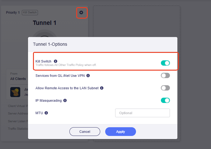

If you would also like to prevent the WireGuard Server clients from falling back to the home ISP connection when the external VPN disconnects, you can enable the Kill Switch for this tunnel.

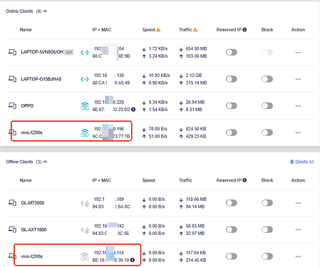

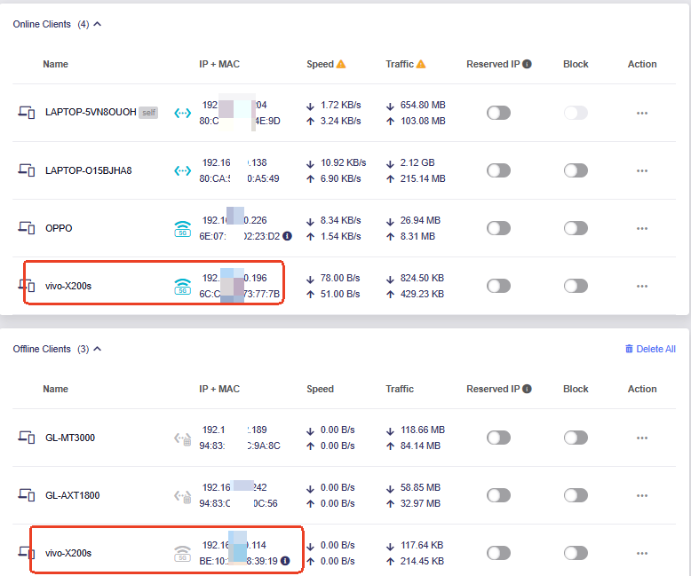

  1. You can use a phone or another device that supports a private/randomized MAC address. Connect it to the router once so that it appears in the client list, then change its randomized MAC address and reconnect it.

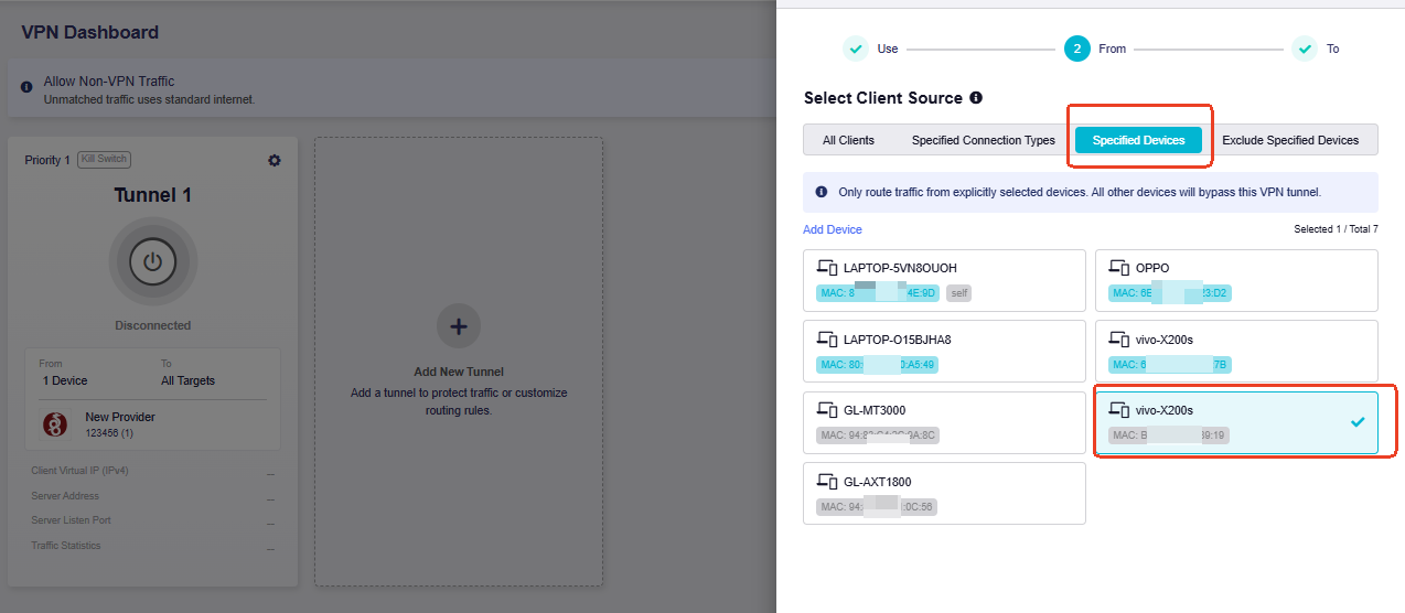

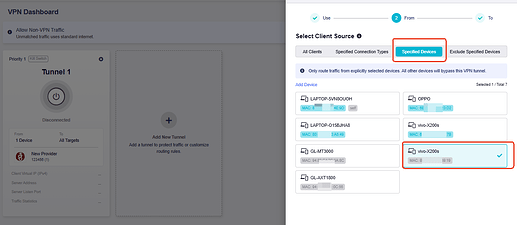

  2. Please change From from Specified Connection Types → WireGuard Server to Specified Devices, and select a spare/test device as a placeholder.
