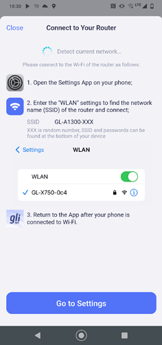

I am connected with the Slate Plus. Here 2,4 GHz, but I also tried -5 for 5 GHz.
What does “detect current network” mean? There are only two networks. WiFi and LTE. It would be nice if I could choose here, of the app needs a hint where to search … It searched and searched. No progress.
On the second try I was also wrong. But writing down the first analysis post brought me to the idea: the phone is using a established internet connection for routing, rather than a disconnected one. Stupid behaviour.
At the moment I set “Mobile Data” to off, everything works in the browser.
