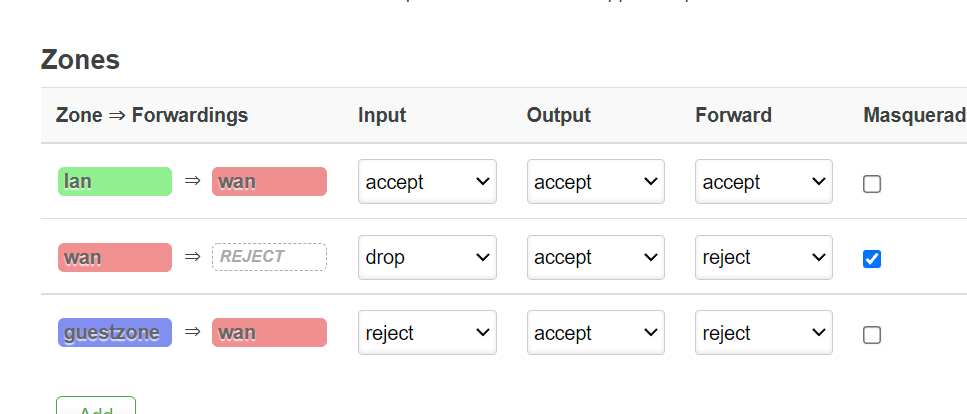

S2S zone missing in Luci - unable to connect between sites from Wireghuard client
Noticed that S2S zone is missing now.
Want to make Wireguard client connected to one site being able to connect to S2S sites.
Any tip? Why S2S zone gone (currently installed 3.211 - but for sure was present in 3.203)
I never see a S2S zone. Are you sure?

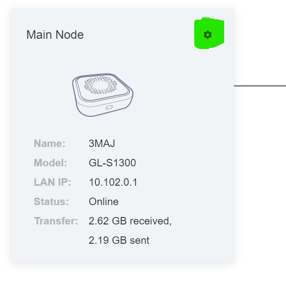

You mean the green highlighted part? It should still be there, no?

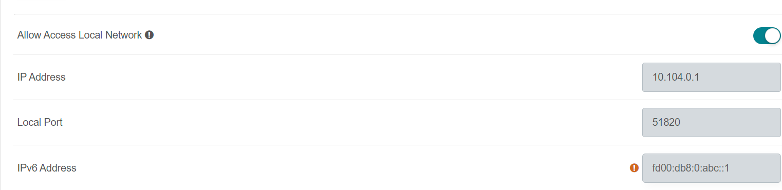

This subnet (10.104.0.0/24) is Wireguard VPN in primary site:

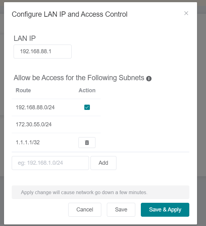

Was adding above subnet in “configure LAN IP and access control” in goodcloud.xyz
Afterwards: when connected with Wireguard to main site: were able to connect with other sites.

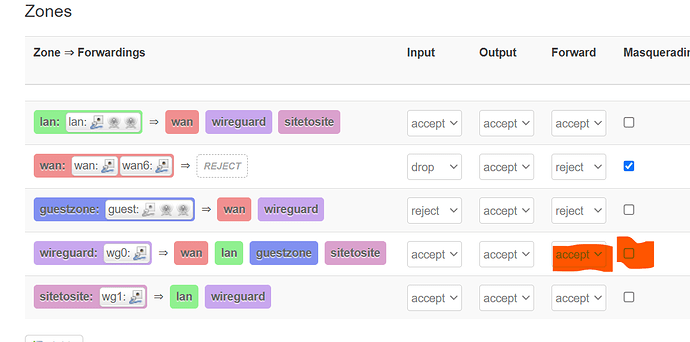

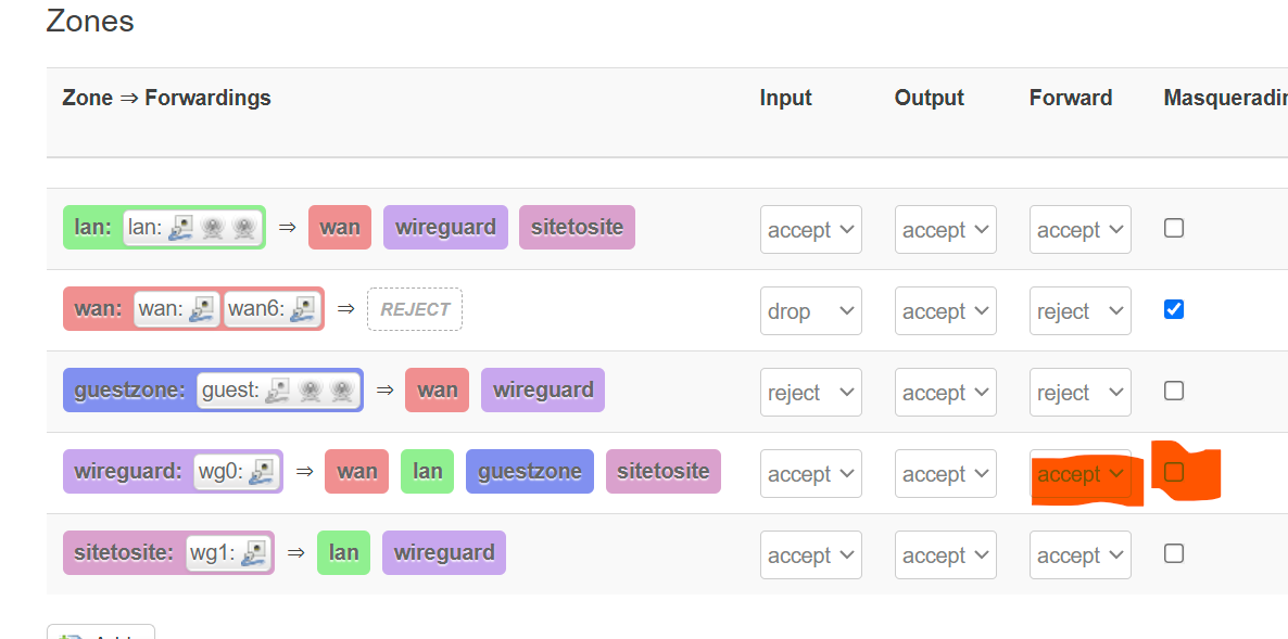

anyway - went back to ISP router and DMZ’ed main site… then LUCI setup to allow all traffic is as following:
  1. add two unmanaged interfaces on WG0 and WG1
  2. Add WG0 to wireguard zone
  3. Create new sitetosite zone with wg1
  4. Disable masquarade on wireguard zone
  5. allow forward between LAN, wireguard and site to site
