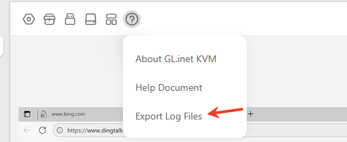

Provide the debug log
system_logs_20251104_074528.zip (54.3 KB)
