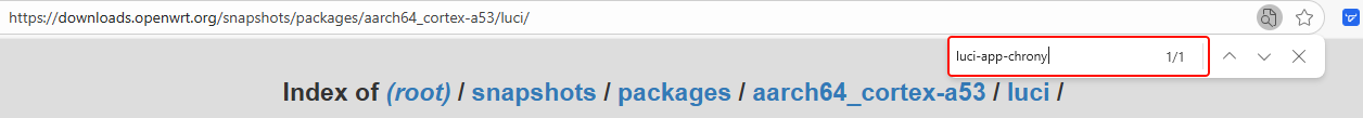

So for the X3000 and the Flint3, luci-app-chrony is not available. Also, should not have -y after install. Otherwise the commands work fine. Thanks for providing it.

Only OP24 supported luci-app-chrony.
For OP23 and below versions, there is no luci-app-chrony in the repo:
So to run OP script i need to flash OP24?
