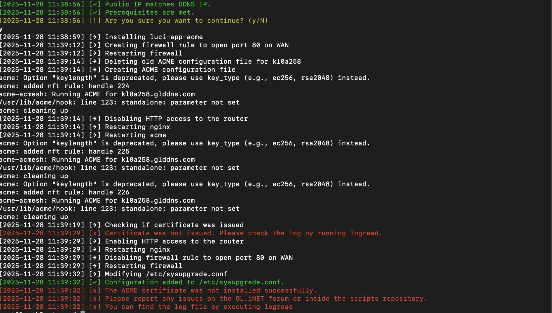

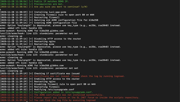

@admon First of all thanks for the hard work you’ve done with the scripts (I’ve already used the adguard one and it worked like a charm)

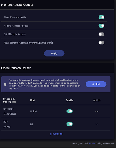

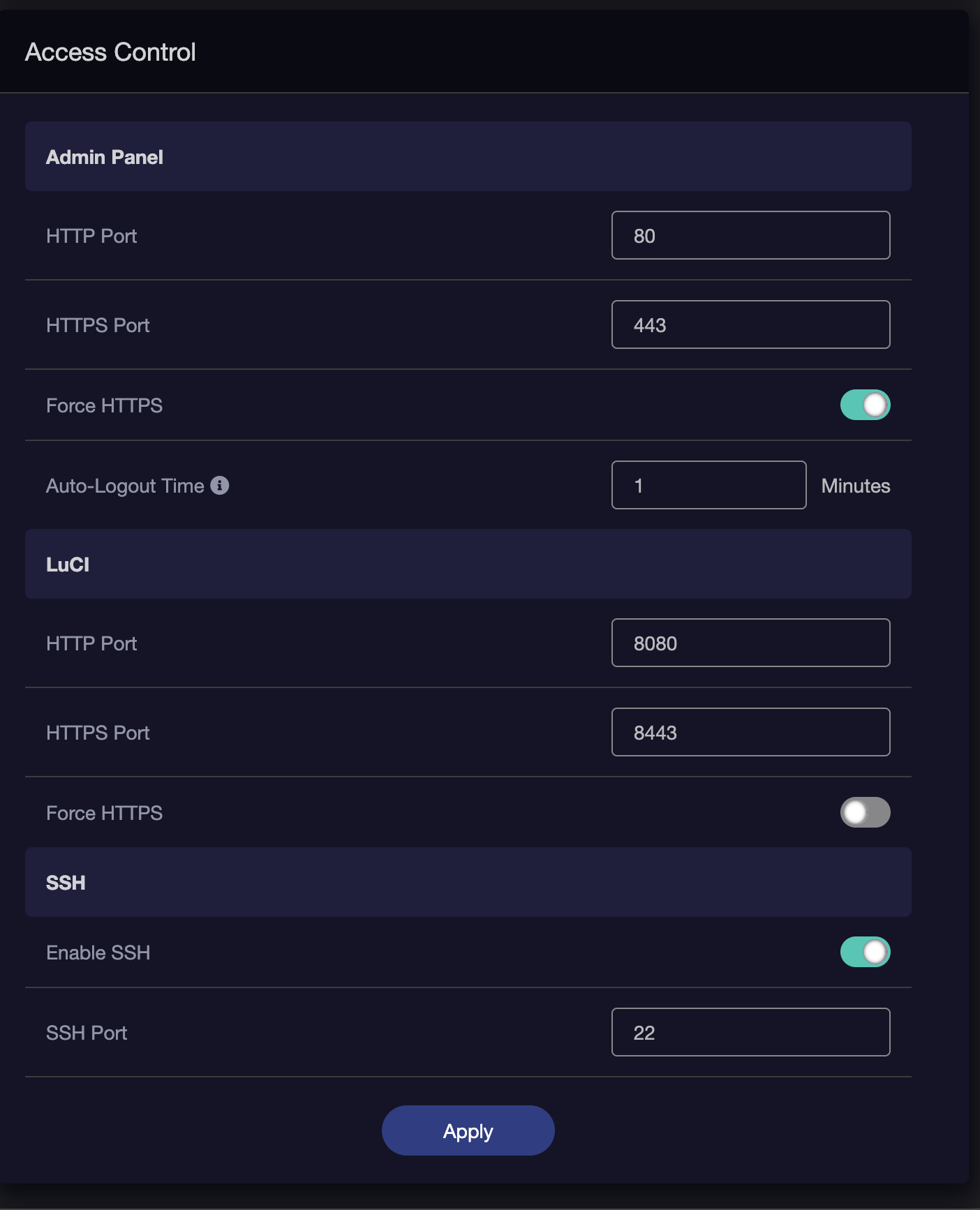

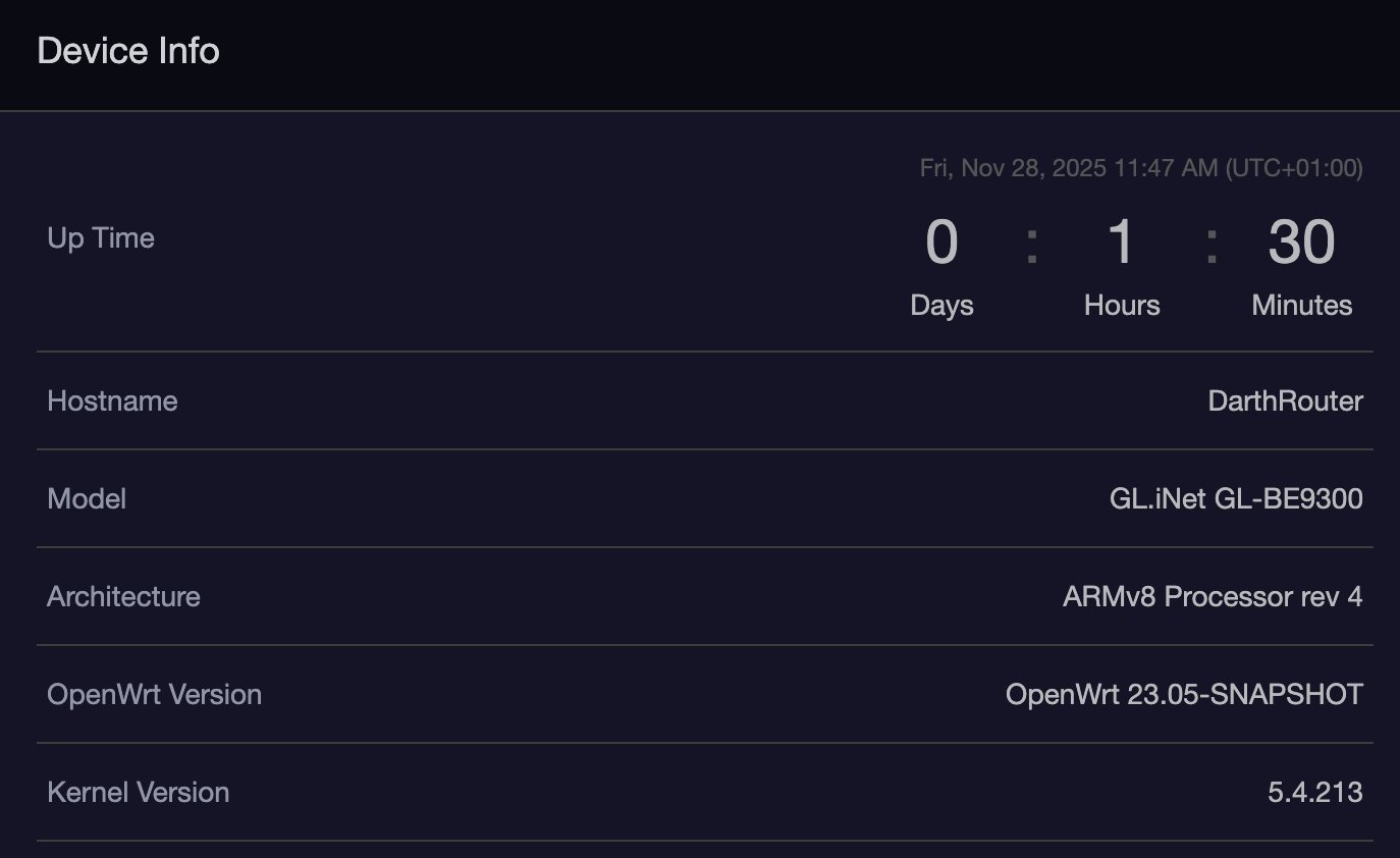

I’m having some issues when using glinet-enable-acme one but I believe it' is because my ISP doesn’t allow me to open ports on wan side even if in the settings page of the router seems enabled.
Trying on a Flint3 running recently updated to 4.8.3 FW, I’m also attaching a couple of images + a logread
logread.tar (348.5 KB)
