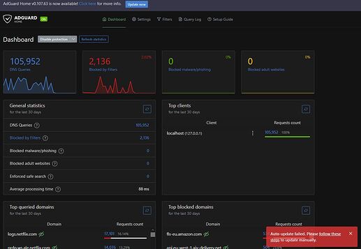

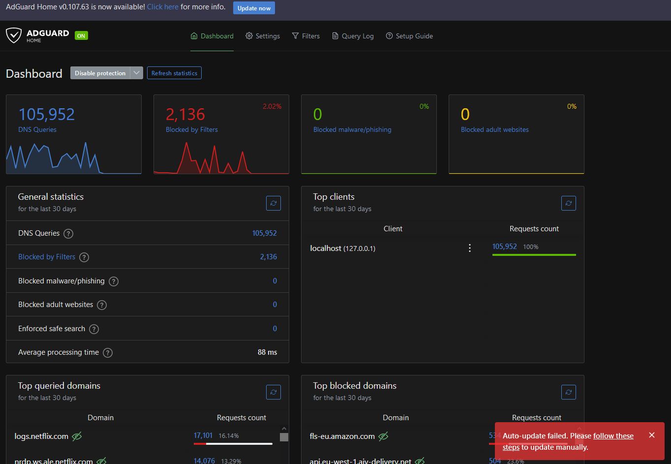

it refused to update until i edited the (procd_set_param command /usr/bin/AdGuardHome --glinet -c /etc/AdGuardHome/config.yaml -w /etc/AdGuardHome -l syslog) then I clicked updated and failed to update.

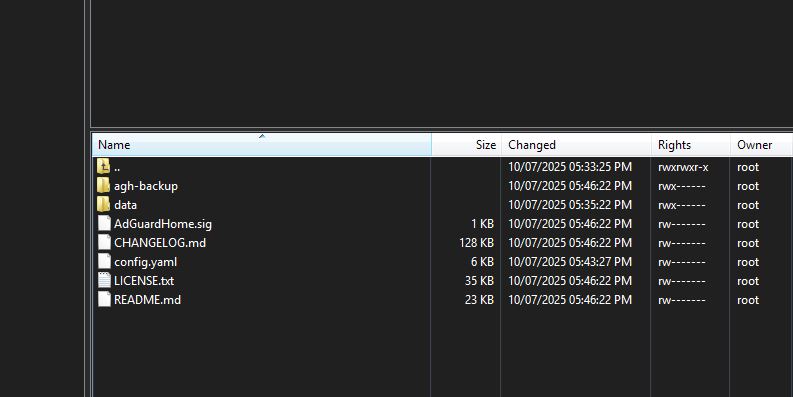

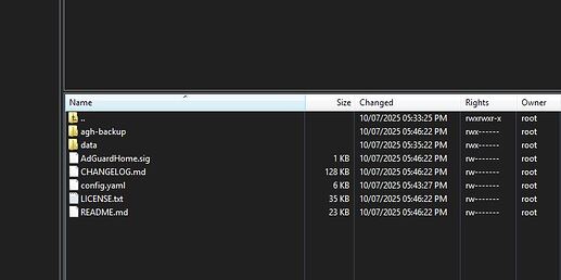

using winSCP no adguardhaome in the AdGuard directory so i guess its compressed somewhere else.

Updating using the AdGuard Self-Update isn't supported while using my script.
Please follow those steps and when you are done, reinstall the current firmware:
Many thanks for the reply i reinstalled the firmware all working but AdGuard still on Version: 0.107.56 does it up date at certain times, and is that correct that you can no longer see AdGuard home in its directory only the data folder and the config.yaml

That’s interesting I was wondering about that, the new firmware’s across the board has stoped me manually updating AdGuard which is a pain and you also can no longer view AdGuard home using winSCP for some reason, I wish they would bring back the update option fir routers with plenty of space like the Flint 2 & 3

Update on F/W 4.8.2 (FLINT2) I managed last night to update AGH really happy about that also managed to get a domain to not go through the tunnel and direct to WAN, I will do more testing tonight but AdGuard is still not visible using winSCP even if I wait 10 minutes, even after upgrade to the latest AGH still not visible, if you check the Flash rom it does not show AGH is taken any space, if I have time I will try the Flint 3 but that seems less stable to me.
