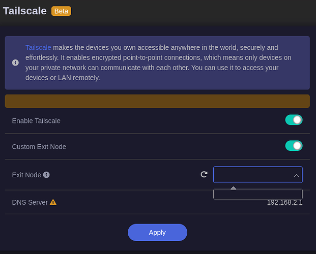

Same issue here, everything else seems to be working fine
Using the unreleased v1.90.0 tailscale binary, so maybe that is the issue (v1.88.3 is the newest as of now, Release v1.88.3 · tailscale/tailscale · GitHub).

Since the newest Tailscale version seems to be an issue, I reverted the repo to v1.88.3
After running the script again, the version should be downgraded.

No, 1.90.2 does not solve the issue.
I just updated my router to 1.90.2 thinking that the issue is fixed with this version and now my Beryl AX is KO
You can restore the older tailscale version by running my script with --restore
Yes, I'll try that. I don't know why now I can't access Beryl using the local IP via SSH or the web interface. I always get a timeout (ssh: connect to host 192.168.8.1 port 22: Connection timed out) on both protocols, even though the router is on and I can connect using the Gl-inet mobile app.
I resolved the issue by adjusting my build process (Copilot did, but I tested it :wink: )
1.90.2 is working now!
