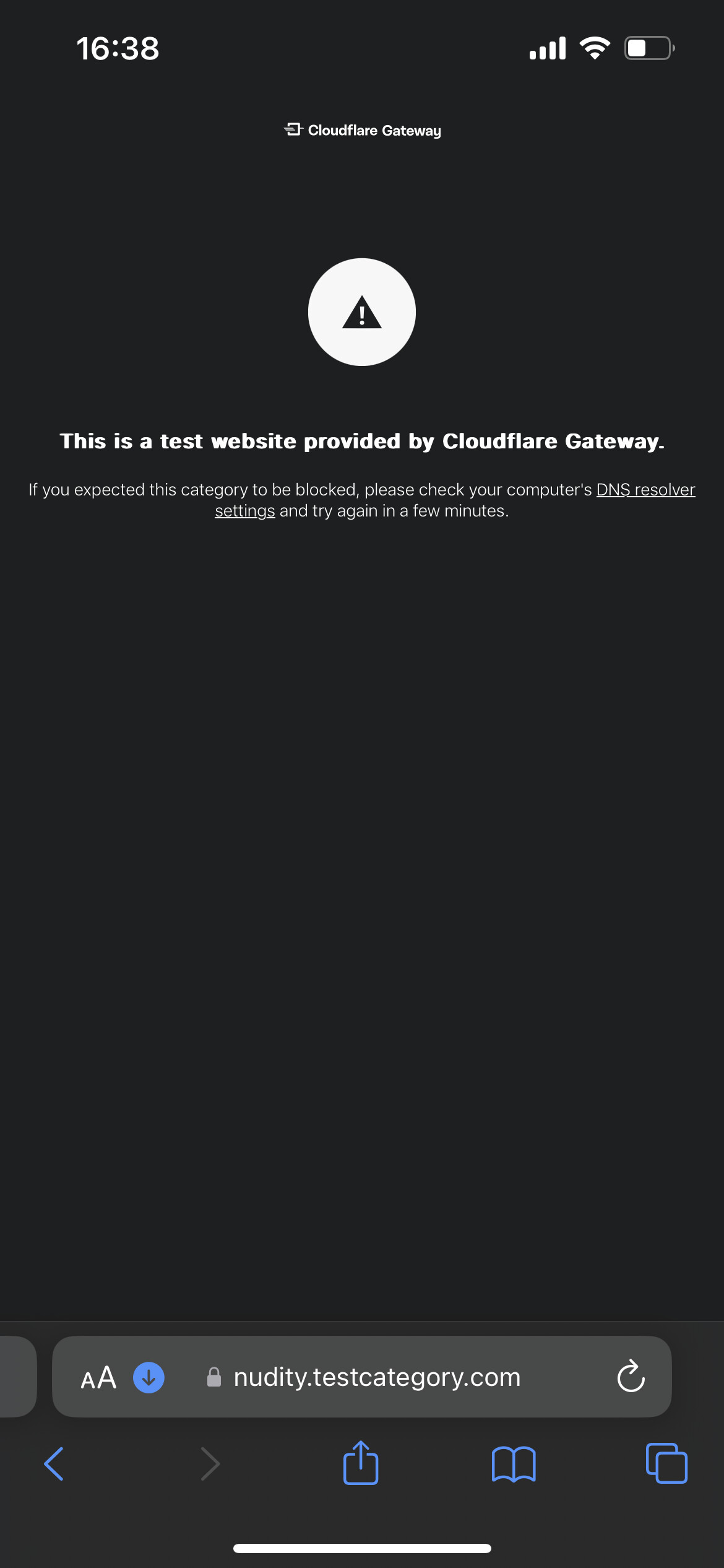

I’ve been trying to setup Cloudflare for Families on my home router. I’d preferably like to do this with DNS over TLS.
As you can see in the images above, I’ve edited the default config, and replaced the servers with the family Cloudflare servers.
However, it has no effect. The test website provided by Cloudflare is still unblocked:
Hoping someone here can let me know what I’m doing wrong, because I can’t seem to figure it out😄
I’m on the GL-AX1800 running the latest public beta.

From dnsleaktest it looks fine, so it could maybe be two things:
  1. the dns server is not flushed you can do this with restarting dnsmasq via /etc/init.d/dnsmasq restart and then on windows ipconfig /flushdns and on the browser also phones chrome://net-internals/#dns
  2. it could be that the connection works, but the actual encryption is not, maybe stubby isn’t started?
If you go to luci and check the console log does it say something like transport error or getdnsapi missing?
Possible it could be it is just working and the test page is wrong, that could be verified in what stubby says in the logs, if it makes the tcp handshake without issues it should work.
