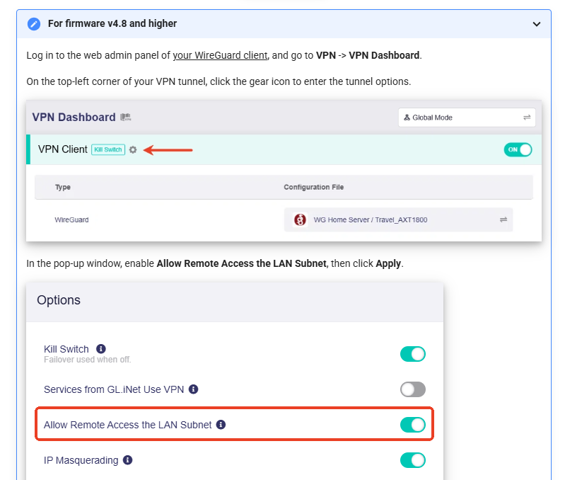

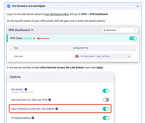

If you want to access the subnet of a GL.iNet router (acting as a WireGuard VPN client) from the WireGuard VPN server, you can refer to this guide:
In general:
  1. Configure a route on the WireGuard VPN server to the subnet of the GL.iNet router.
  2. On the GL.iNet router acting as the WireGuard VPN client, enable “Allow Remote Access the LAN Subnet.”
That’s all that’s required.
