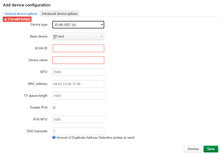

Did you config the VLAN in the Luci for interface LAN like the scrennshot? Save and apply but it does not work?

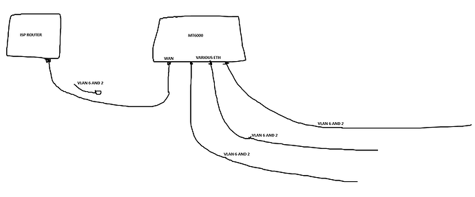

To add more information (sorry for my bad drawing skills):

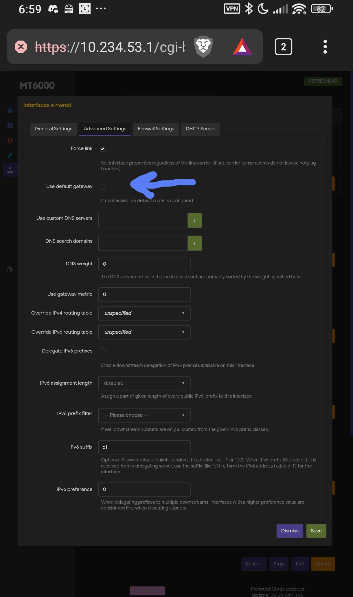

Hmm, it sounds vlan 6 is ment for isp wan and 2 for iptv or something?
If vlan 6 worked, and vlan 2 not, did that happen when you created the network interface?

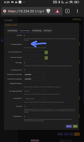

In that case this is a conflict with the default gateway checkbox, if you edit the interface in luci click on advanced settings, there is a checkbox.
It should follow wan, or a other default gateway interface.
Correct, VLAN 6 is for Internet and VLAN 2 for IPTV (Movistar + Spain).

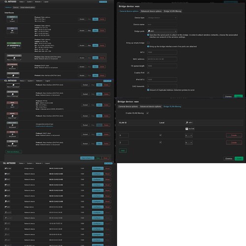

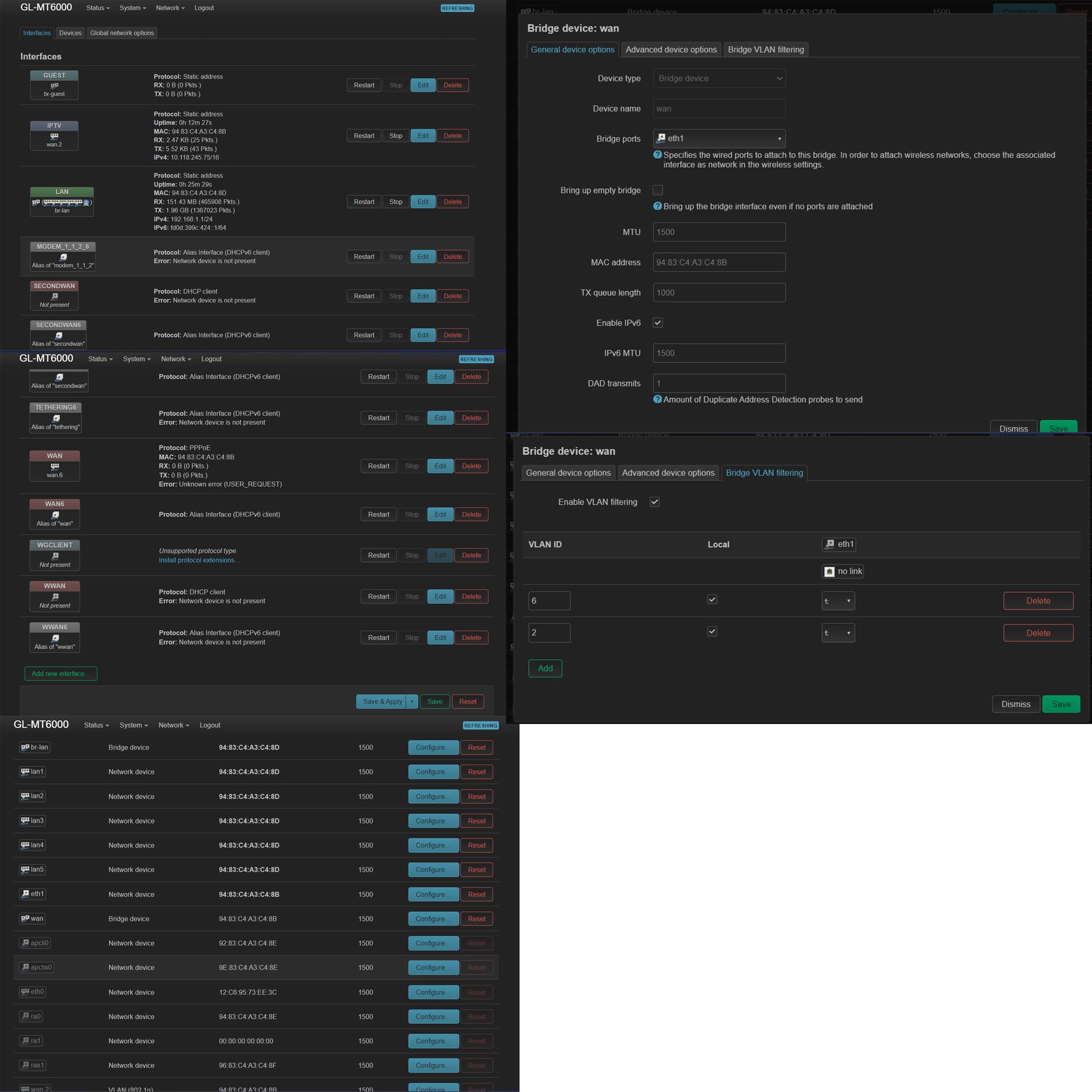

This is how everything was created and still no IPTV on the TV box.
the pppoe connection isn't working, i'd recommend trying eth1.6 directly just to be sure its not a device issue but a user credential issue.
For the iptv i do see a dhcp lease so that is fine, though it is important you have the default gateway checkbox unchecked.
If it still doesn't work i think you need to enable igmp snooping on device br-lan, also make sure all the switches in your network are igmp snooping supported otherwise they may end up stripping the packets.
Then finally although im not sure if this is needed but looking to the type of setup it looks familiar with a old isp/iptv setup i used to run, you might also need to install igmpproxy.
