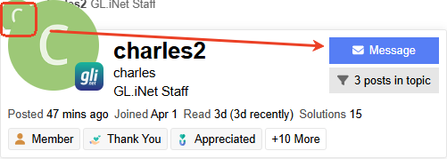

Once the issue has been reproduced, could you please send the system.log file to us via private message? We will review the log and coordinate with our development team for further analysis.
