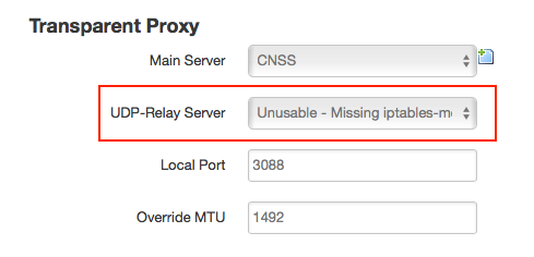

  1. The connection is very slow, even for normal web surfing. I noticed in the Advanced → Services → Shadowsocks → Transparent Proxy … the UDP-Relay Server shows “Unusable - Missing iptables-mod-tproxy”. I could not find this in the Applications - Plug-ins

Screenshot
Not sure about udp relay server. It may not be used.
About DNS, please use DNS over tls from cloudflare.
SS doesn’t support udp so you have to use tcp for dns.
