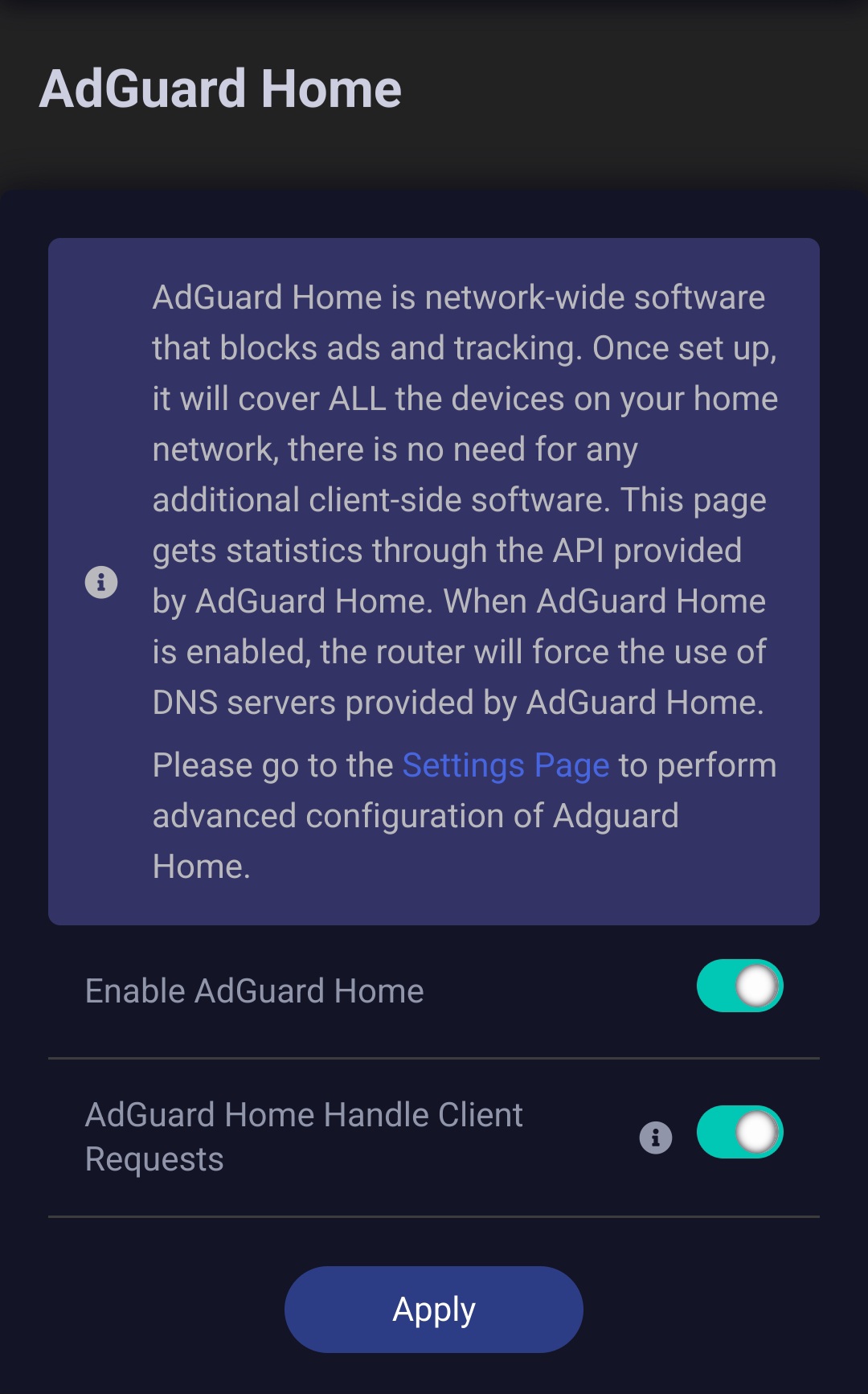

But first, just a couple of screenshots to help orient folks.
AdGuard Home options can be found at Applications > AdGuard Home:
(Note this screenshot shows enabling AdGuard Home and enabling it to handle client requests directly.)

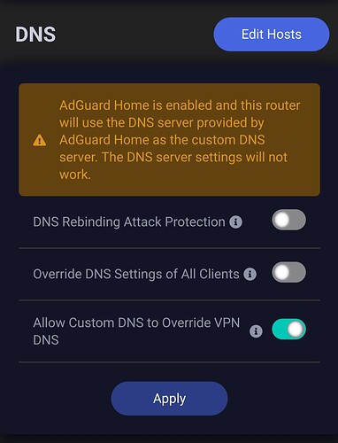

DNS options can be found at Network > DNS:
(Note this screenshot shows allowing custom DNS to override VPN DNS.)
