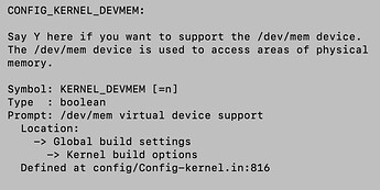

If you allow, another question, is how to add support for /dev/mem virtual device support?
What is added to the
$make menuconfig ==> Global build settings. ==> Kernel build options ==> [*] / dev / mem virtual device support
From the root of the build directory, ./scripts/diffconfig.sh will show all changes relative to the “default” configuration for the device.
Within make menuconfig, the ? key will provide the “help” for the option.
In the worst case you will be able to compile just the kernel and replace the kernel into the GL imagebuilder before making your image, with any changes you need. Make sure the kernel is from the same version of OpenWRT the imagebuilder is using ![]()
