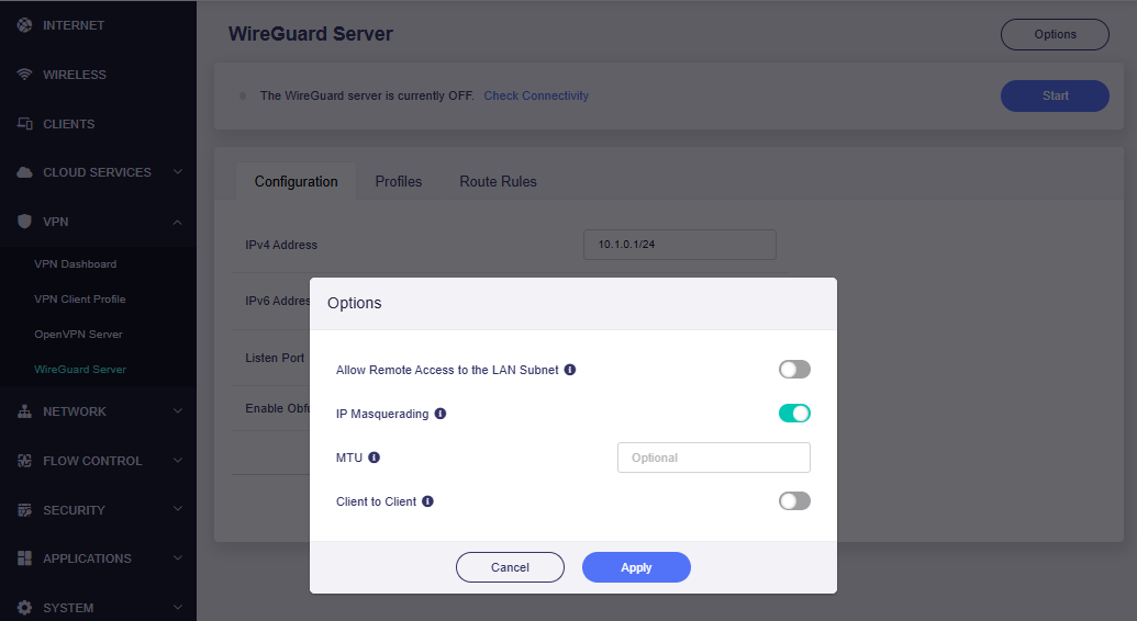

In the WireGuard Server Settings I added a routing roule with LAN B as the Target Net and 10.1.0.2 as the Gateway.

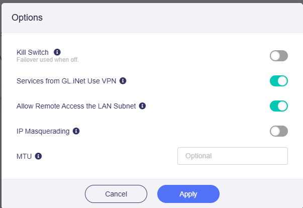

On the VPN Dashboard I set the VPN Client Options:
  • Kill Switch: OFF
  • Services from GL.iNet Use VPN: ON
  • Allow Remote Access the LAN Subnet: ON
  • IP Masquerading: OFF

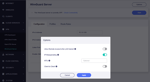

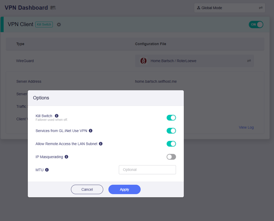

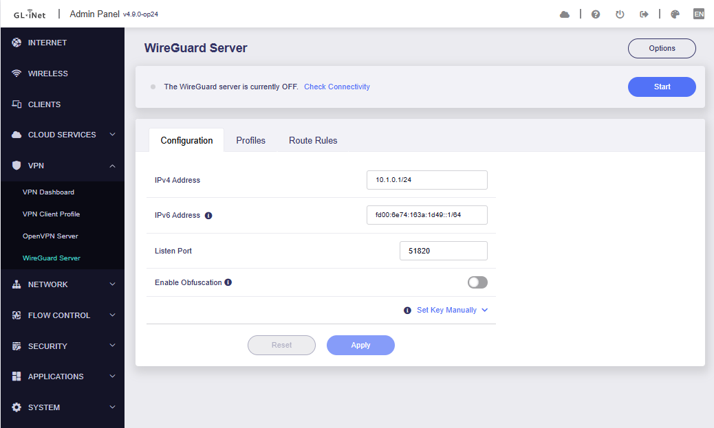

To better understand the full picture of your current configuration and help troubleshoot the issue more effectively, could you please provide the following screenshots?
  1. Server side: Flint3
    VPN > WireGuard Server main page
    VPN > WireGuard Server > Options

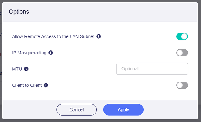

  2. Client side: Spitz AX
    VPN Dashboard and current WireGuard client Options.
and finally, trace route from a host in the server net to a host in the client net.

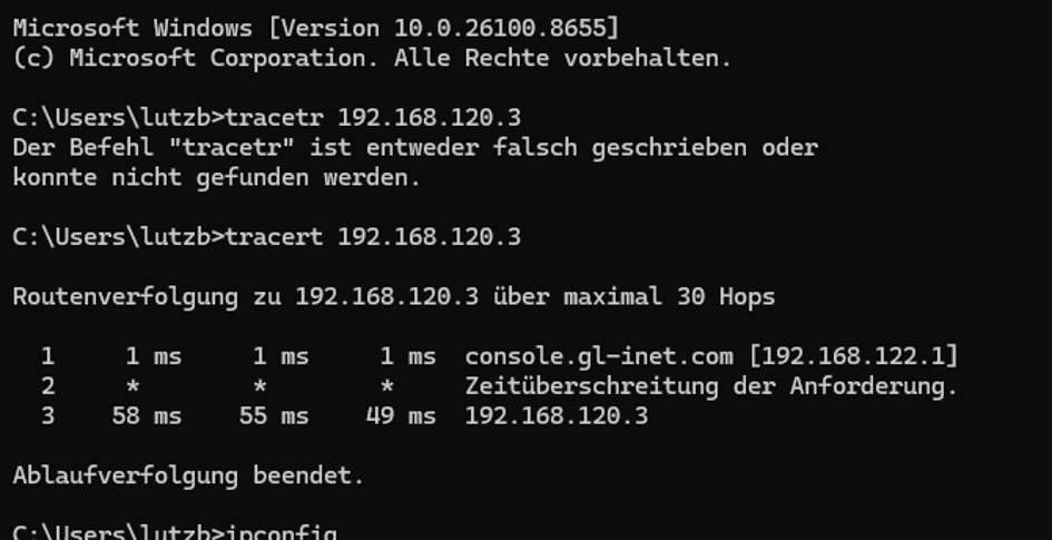

This looks good as well. ICMP is working. Though, connecting the host 192.168.120.3 by the browser on same host fails when connected to the Server site with ERR_CONNECTION_RESET
Connecting the same host on the Client site works just fine.

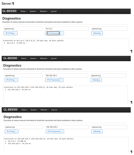

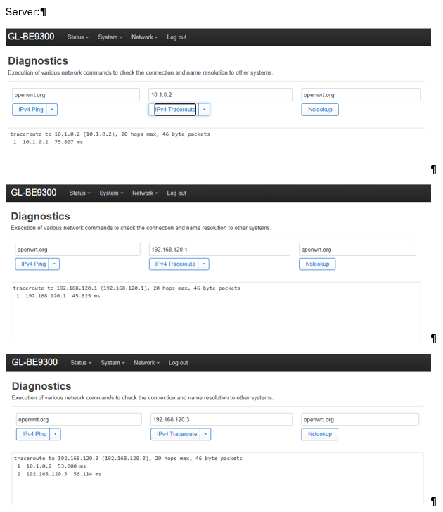

Here are the additional trace-routes from Server side
3rd screenshot (Client)
2nd screenshot

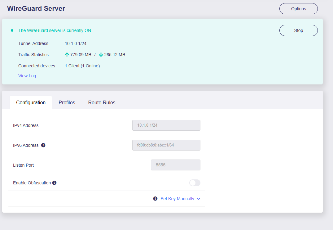

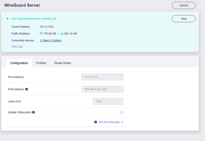

Hi Charles, thanks for comming back. Sorry for the delay.
Unfortunately, as a “new” user I can only attache one media on a post…
Please find requested Screenschots here.
Server:
( I’ll add other screeshots as I can…)
Additional, there are some trace-routes - From Luci Diagnostics trace route to VPN address of client, to LAN address of client and even to a host in Client LAN works fine - so ICMP works.
→ This actually looks good!!!
Though, connecting the host 192.168.120.3 by the browser fails when connected to the Server site with ERR_CONNECTION_RESET
So TCP is somwhow not correctly routed …

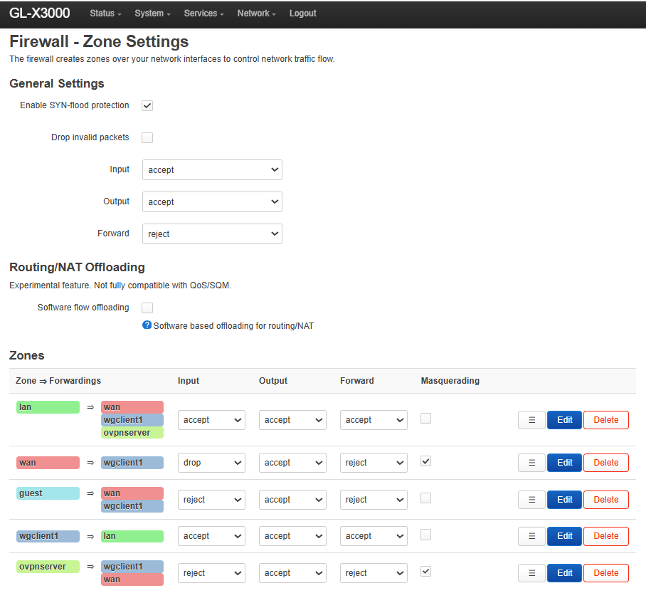

Hi Charles,
The issue only exist when connected via modem.
When I use a repeater connection to the Server WLAN everything is fine.
When I use another modem (same SIM card) and connect via ethernet to WAN port everything is fine as well.
Firewall Zones look good to me though:

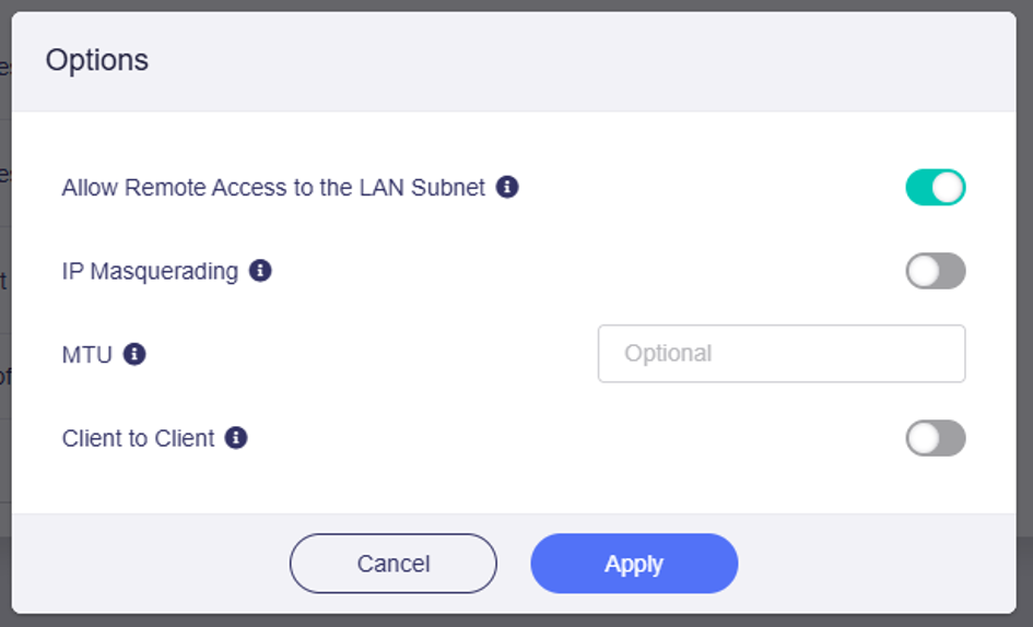

Since the routing and ICMP connectivity are working, and the issue only occurs when the Spitz AX uses its internal cellular modem, we would like to test the tunnel MTU.
On the Spitz AX, go to `VPN Dashboard → WireGuard Client → Options, set the MTU value to 1280, click Apply, and reconnect the WireGuard tunnel.
After reconnecting, please test access to 192.168.120.3 again from the Server-side LAN.
If the connection works with MTU 1280, you can gradually increase the value and keep the highest setting that remains stable, such as 1320, 1360, or 1380.
